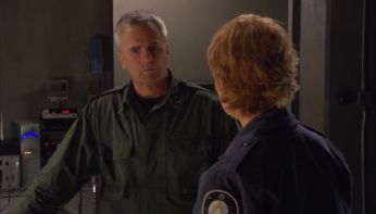

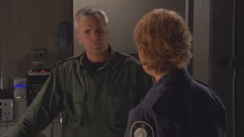

    Here's a quick example of the difference you might see when the levels are wrong. The first pic is correct and the second one is "washed out". It might be a playback rather than an encoding problem though, and if that's not the sort of difference you're seeing, maybe I'm on the wrong track.....
    For MPC-HC you should be able to ensure correct playback levels for most video by going into it's options and changing the renderer to Enhanced Video Renderer (custom presenter) under "Playback/Output". Restart the player and the levels should then be correct, but you can check under the menu: "View/Renderer Settings/Output Range" and ensure the "0-255" option is checked. If the options there are greyed out, you're probably using the wrong renderer (and the levels could be wrong). That should ensure MPC-HC is displaying your encoded video with the correct levels for a PC monitor. Hopefully the mjpg video will look the same.
    [Attachment 29278 - Click to enlarge]
    [Attachment 29279 - Click to enlarge]
    I realize that you use those pictures to demonstrate the difference but I don't think the second one looks much worse than the first one. While the second one's blacks are brutally capped the first one is simply too dark.

    Well...no, the two pics don't look all that different, the difference being mostly in the darks and brights. Actually the back of the shirt doesn't look "almost pitch black" in either pic. Looks darkish blue in both. In the darker picture the average RGB values on back of the jacket are from 12 to 16, with elevated blue. In the lighter pic on the bottom the average values are twice as bright at average RGB 24 to 32 or so (So, yeah, the darks are cut short a bit in the lower pic, and so are the brights). At full size in a running video you'd certainly see more of a difference.

    The older guy's bright hair highlights are ~15 RGB points brighter than in the lower pic. The upper pic also has a wider contrast range. Flipped back and forth in Photoshop layers, used pixel samplers, etc., that's what I'm getting. Remember also that the pics are converted YUV-RGB.

    I just opened an AVI DVD re-encode I had handy (very likely AutoGK), but I didn't touch the levels when encoding. The second pic is the same frame converted back to TV range with a MPC-HC pixel shader. Either that or I disabled the video card's expansion of the levels while MPC-HC saved pic 2. I can't remember. Same result either way (for the purpose of the exercise). The difference is definitely PC and TV levels. The alternative would be for pic 2 to be correct, even though it looks washed out to me, but if it's correct it'd mean a PC to TV levels conversion would result in a very over-the-top washed out image.
    To be honest I don't think the first pic looks too dark. I'm just using my CRT at the moment but compared to "black" the shirt's many shades of grey away. I opened the second pic with Irfanview and had a quick look with it resized fullscreen. I'm not seeing any crushed blacks. I'm seeing Xvid blocking, but I think that's all it is. It's been resized down and back a couple of times now but I'm pretty sure the flat areas are courtesy of Xvid.

    Don't forget the first pic is the original video with expanded levels to display correctly on a PC monitor. So it'll display correctly as a jpg. It should be PC levels, yes? If nothing in the first pic is black and the lowest value is 12, doesn't that make sense, given 0 is now black and it's now full range?
    I checked and pic 2 must have been saved by disabling the video card's expansion of the levels. Converting with a pixel shader had no effect on the image MPC-HC saved. MPC-HC obviously doesn't expand the levels when saving images. If it's washed out on the monitor, the saved image looks the same.
    So..... pic one is displaying with the same levels as the video on the monitor. The levels have been expanded by the video card.
    jpg = fullrange levels. The jpg displays with correct levels. Pic one is how it should look, artistic and video production criticisms aside.
    Pic two, no levels expansion, original limited range levels, jpg = full range levels, jpg looks washed out.
    Now that's finally sorted..... anything not to taste should be blamed on the accuracy of the video card's levels expansion, Xvid, resizing, jpg compression, Xvid, the entire film production crew and their immediate families, artistic choice, the DVD transfer process, not me, and possibly also Xvid.
