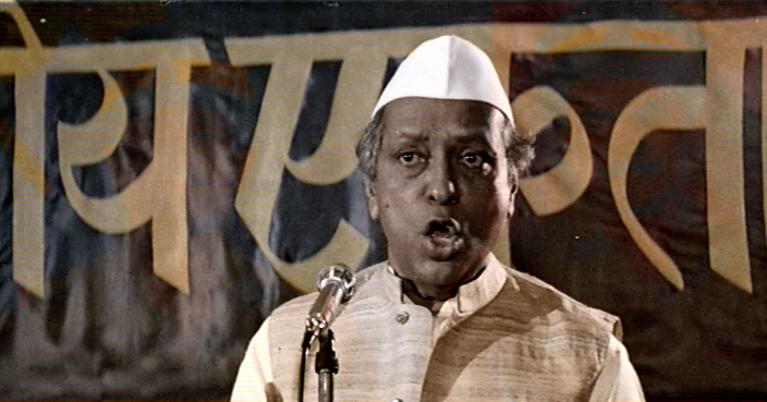

    I am checking dat thread for Dependencies now then i'll do some test latter, your test work nice on spots and scratch but i doubt on TFM+Decimate like that in script won't perform nice i doubt it may cuz to this artifact.
    https://forum.videohelp.com/images/imgfiles/IXpgqHL.png?1
  9. That chroma artifact is caused by treating interlaced YV12 as progressive YV12. This is very often caused by VirtualDub -- it treats all incoming YV12 as progressive. TFM().TDecimate() won't produce that unless you screw up the chroma channels before calling them. Or if the video is screwed up before you got it.
