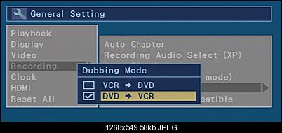

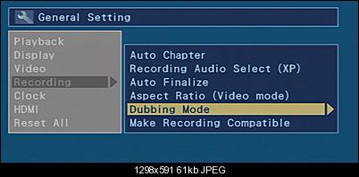

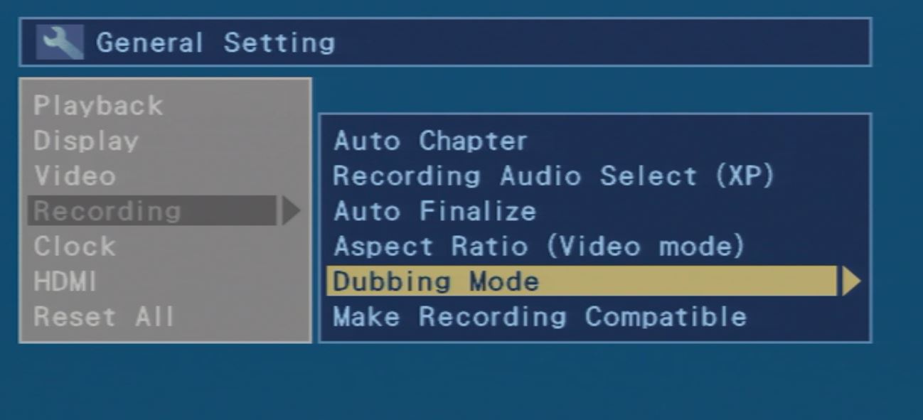

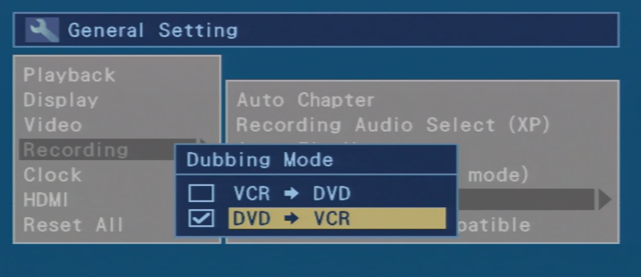

  17. Newer VCR combos, when copy protection is present, the VCR will respond the same way as a DVD Recorder; it will not activate the record feature.
    Just curious, is there a recording mode as seen in the photos attached?
ID:	29276Click image for larger version

    Aug 2006
    Jacatone's combo only records on the VHS side. The DVD side is just a player. I looked at the manual, which says: "It is not possible to record from DVD/ Video CD/ CD to VHS tape using DECK." So, no, the deck doesn't allow dubbing from DVD to VHS or from VHS to DVD.

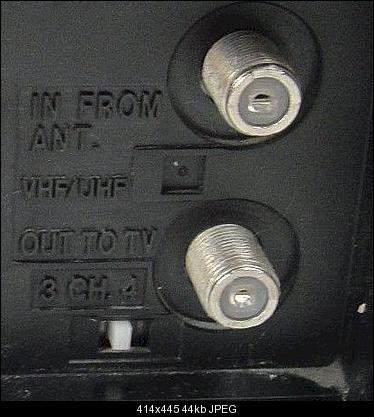

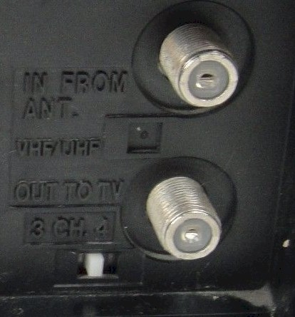

    Try reading and understanding. Here's a hint....If you select channel 3 on the VCR's internal tuner.....you are watching channel 3 (CBS, NBC. ABC, CNN etc etc etc).
    http://en.wikipedia.org/wiki/Channel_3/4_output
    THIS is where you "select" channel 3 as the OUTPUT on the VCR.....not via the remote/internal tuner:
