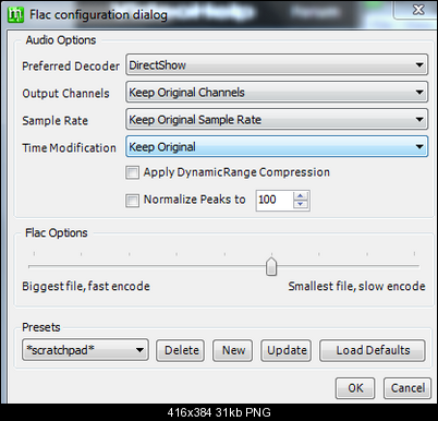

    yeah i converted to flac with DirectShow before you wrote. and it worked. but bit depth is 24. original bit depth is 16. how to fix it?
    this is the settings:

  9. You probably need to set ffdhow to only output 16 bit, assuming you're using it for decoding. Uncheck all the other options under the Output section except for "16 bit integer". If that doesn't work you'll need to convert the 24 bit version to 16 bit with another program.
