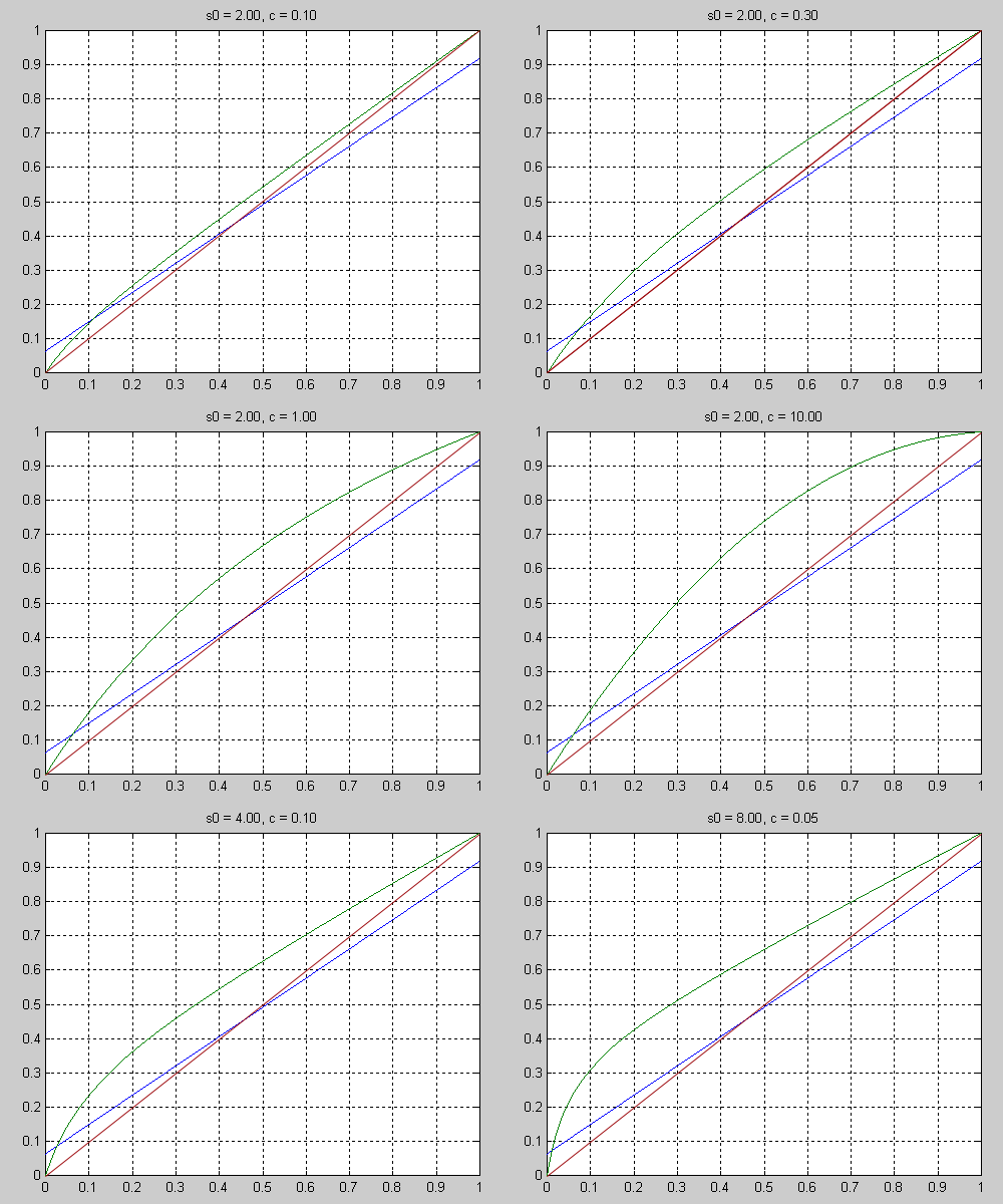

  14. Yes, I think it's this one, I recall there was another version with fewer graphs, this one shows the original luma in TV range (blue line), then how the blue line would look in PC levels (red line), then the curve (as shown in green) that converts range to PC levels while at the same time stretching the dynamic range on local sections of the luma plane (dictated by the "c" parameter).
    I upload here since it's related to SMDegrain too.
Name:	fslg_remap_luma_search_clip - graph.png
  15. Originally Posted by Dogway View Post
    [Attachment 37961 - Click to enlarge]
    thank you for the upload and fast reply
