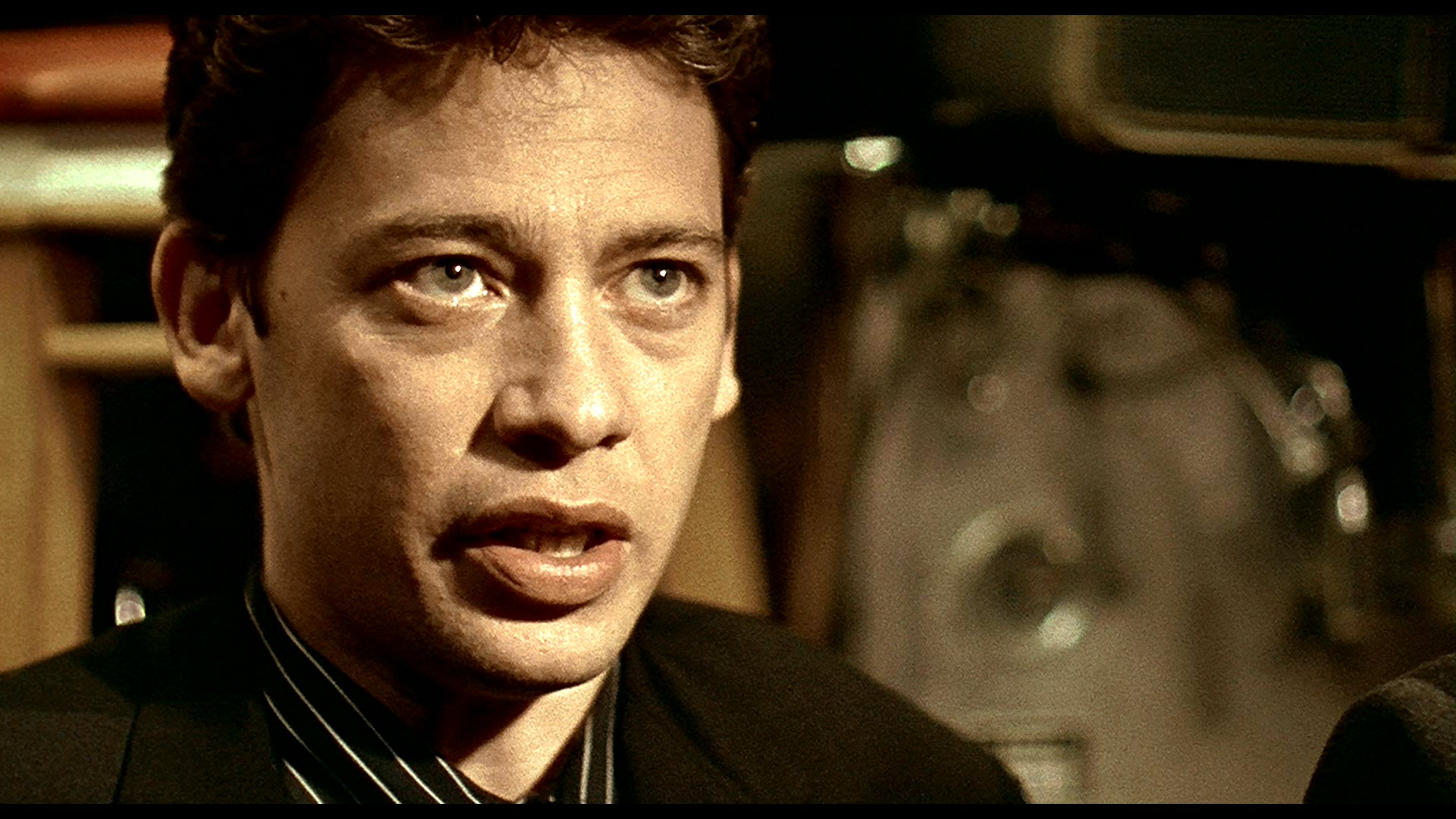

  4. Hi Dogway,
    Firstly thank you for creating this script and also keeping maintained.
    Quick question.
    When encoding with all chroma off would this allow me to set much higher thSAD value and lessen the risk of ghosting?
    the script I'm using is
    SMDegrain(tr=3,thSAD=600,refinemotion=true,lsb=tru e,chroma=false,plane=0)
    But in some cases where large chunks of noise bloats the encoding (e.g. Lock, Stock And Two Smoking Barrels, Young Frankenstein, Highlander) i have used the following settings to halve the resulting CRF20 bitrate.
    SMDegrain(tr=3,thSAD=1000,prefilter=2,refinemotion =true,lsb=true,chroma=false,plane=0)
    I have checked the output of these 3 movies using the above settings both on computer and TV and i can't see any ghosting occurring. i've attached a comparison between the original and re encoded.
  5. No, disabling chroma motion vectors only works in very bad sources, like low resolution blocky ones.
    This is a fairly good BDR source so it doesn't make any improvements other than speed.
    If you like the results use whatever suits you.

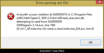

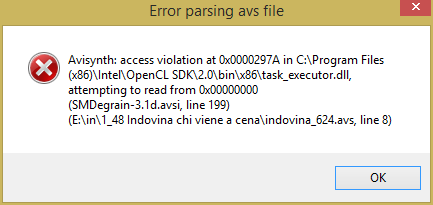

  16. v.3.0d
    Smdegrain(Prefilter=2,Show=true)
    is there something i typed wrong way in smdegrain?
  17. Click image for larger version
    PHP Code:
    #SetMTMode(5)
    SetMemoryMax(2048)
    LoadPlugin("D:\eseguibili\media\[url=https://www.videohelp.com/software/DGAVCDec]DGDecNV[/url]\[url=https://www.videohelp.com/software/DGMPGDec]DGDecodeNV[/url].dll")
    DGSource("E:\in\1_48 Indovina chi viene a cena\indovina.dgi")
    CompTest(1)
    ChangeFPS(last,last,true)
    #SetMTMode(2)
    SMDegrain (tr=6,PreFilter=4,thSAD=600,contrasharp=false,refinemotion=false,plane=4,chroma=true,lsb=true,mode=6)
    #SMDegrain (tr=6,PreFilter=2,thSAD=600,contrasharp=false,refinemotion=true,lsb_out=true,plane=4,chroma=true,Globals=2)
    #SMDegrain (tr=6,            thSAD=600,contrasharp=false,refinemotion=true,lsb_in =true,plane=4,chroma=true,Globals=1,mode=6)
    #Distributor()
    Any idea?
  18. Worked for me. Did you update to latest Dither 1.27?
    Due to the error message it could be one of the KNLMeans dependencies, do you have Visual C++ 2013 Redistributable (x86)? Otherwise try to update CL drivers (nvidia or Intel HD drivers).
  19. Originally Posted by Dogway View Post
    Just add device_type="GPU" to your script options for KNL, it works.
  20. A question, do you have a discreet GPU (Nvidia, AMD)?
    I have my iGPU disabled on BIOS, so this could be a matter of defaulting to IntelCL instead of your other GPU (although it should work either way).
  21. Originally Posted by Dogway View Post
    Discreet Nvidia as main GPU. Intel one enabled in bios as I do tests with Intel video decoders.
    Want to use Nvidia as it is faster.
  22. yeah, probably that's the reason, KNLMeans (for some reason) may want to default to Intel, while your main system's GPU is the Nvidia. I will try to reproduce this and change according.
