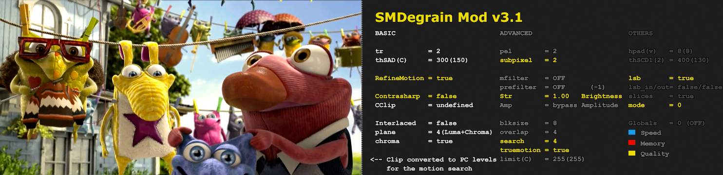

  1. Doom10 died without notice, so I hope to make videohelp the new home for SMDegrain() and the rest of tools and scripts I made over time.
    SMDegrain is simply a wrapper for mdegrain, nothing fancy or magical. Just convenient automations for common tasks to get things done fast and in good quality, without forgetting some flexibility too. I created this based off my needs, and evolved from there. I took Caroliano's SMDegrain() as a base to build it because I also wanted something simple to use and straight to the point, in the same sense as the original script indicates: "To make your scripts shorter and less geeky". Think of it as a front end for mvtools2+mdegrain.
    The main features of this function are:
    High bitdepth denoising
    Higher temporal radius (tr>3)
    Contrasharpening
    Interlaced support
    YUY2 support
    Prefilter and Motion Filter support
    Motion Vectors Globals Input/Output
    RefineMotion Option (MRecalculate)
    +some more little options and any combination of the above supported
    Everything is OFF by default so you just type smdegrain() and it works, but as soon as you start setting more parameters on you will find to need more plugins and scripts. To run it you will need at least mvtools2 and masktools2. Read on dependencies to know more.
    A simple SMDegrain() call (for non HD sources) would be equal to:
    super_search = Dither_Luma_Rebuild(S0=1.0,c=0.0625).MSuper(rfilter=4)
    bv2 = super_search.MAnalyse(isb = true,  delta = 2, overlap= 4)
    bv1 = super_search.MAnalyse(isb = true,  delta = 1, overlap= 4)
    fv1 = super_search.MAnalyse(isb = false, delta = 1, overlap= 4)
    fv2 = super_search.MAnalyse(isb = false, delta = 2, overlap= 4)
    MDegrain2(MSuper(levels=1), bv1, fv1, bv2, fv2, thSAD=300, thSADC=150)
    As you see, nothing too outrageous, just a nice good code block you save from typing and hence human induced errors.
    I have to specially thank cretindesalpes for bearing my incessant questions related to this function.
    enjoy!
    SMDegrain() Mod v3.1.2d (21-07-2015)

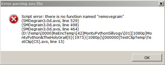

  4. First try today i get an error: no named function named "Dither_lut8"
    i tried this this:
    SMDegrain(tr=3,thSAD=400,contrasharp=true,refinemo tion=true,lsb=true)
  5. Originally Posted by themaster1 View Post
    i tried this this:
    Dither_lut8 is part of the dither package
    http://forum.doom9.org/showthread.php?p=1386559#post1386559

  29. Originally Posted by Dogway View Post
    What do you mean defaults were the same? A few things change, hpad/vpad, blksize, pel, subpixel...
    You're right, my mistake. Next time I'll look at everything...
    Remove old Repair and RemoveGrain and drop RgTools.dll in the folder. RgTools has the old function calls embedded in the plugin (ie. Removegrain(), etc). If it fails probably you removed something else, did you keep RemoveGrainHDS.dll?
    After adding the RgTools.dll and removing the RepairSSE2.dll and RemoveGrainSSE2.dll, the call "SMDegrain(ContraSharp=True)" results in the error message
    RemoveGrainHD.dll and RemoveGrainHDS.dll are still in the plugins folder.
  30. x86 right? if so install Visual Studio 2012. I think I might add that to documentation as well. Link
