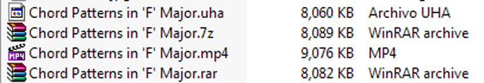

    Just did a test on a highly compressed mp4 file (mostly static images, very little moves, instructional)
    Even so getting more than 10% reduction on this file is quite good, getting anything near 50% would be imposible for this file.
    Used programs 7-zip, WinRar, WinUHA-UHARC - always with Best Compression activated.
  12. Originally Posted by NoBuddy View Post
    Format profile : Baseline@L3.0
    Format settings, CABAC : No
    I wouldn't quite call it "highly" compressed. You can tell from mediainfo that the video is not optimally compressed - it uses baseline profile (no b-frames, no cabac) . So typical compression gains you would expect will be larger.
    Take a more commonly used compression scheme, e.g. x264 with high profile (uses cabac and b-frames), and your typical compression gains would be <1% . You tend to gain a bit more with audio than highly compressed video like x264. Less compressed video like xvid would typically gain 1-2% in compression
    eg. video only, using x264 (no audio) . They all are larger, except for uharc, which is 0.05% smaller . If anyone wants I can post link to video
    original 10,787,390 bytes
    winrar default 10,787,480 bytes
    7zip default 10,927,963 bytes
    uharc default 10,782,399 bytes

    poisondeathray is right
    My compressed, small mp4 file was made for a weird mobile device, low bitrate to get it under 10Mb - we had to send it by email.
    Now I used High profile, and WinRar doesn´t even reach a 1% gain.
    So, as all and everybody already told you, don´t expect magic.

    If it worked, don't you think manufacturers would have done this?
  26. Originally Posted by KBeee View Post
    If "Zipping" a video file could reduce the size by 50%, think what that would imply.
    Stick a hardware decoder chip inside a BluRay player, and suddenly your 50GB disk is 100 GB, DVD's go from 8 GB to 16 GB etc.
    Essentially, this is already the case. The video isn't in a ZIP container but it's entropy encoded just like data in a ZIP file.
  27. Member
    I think you're misreading my post.
    IF just "Zipping" the finished already compressed video were possible for a 50% video filesize reduction - It would have already been done, and saved millions instead of creating new formats. Heck, you could Zip the Zip file and get it down to 25%...
