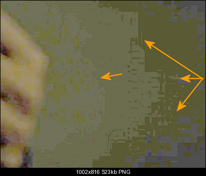

  1. What do you call what's shown in the image below? It happens in low light situations where the bitrate is too low. Banding? Artifacts? Something else?

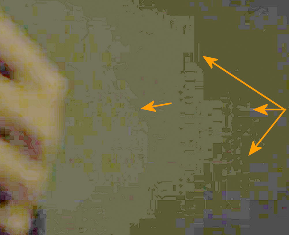

    Well, it's harder to see when it actually IS dark, but bumping it up in brightness makes it OBVIOUS that it is banding (aka too few quantization levels). Note that my bumping it up (below) was done in 16bit to alleviate the loss in range (so the great majority of that banding already was there prior to bumping up).
    It IS an artifact: An artifact just means an unintended detrimental feature addition that is a byproduct of the process. Banding is one type of artifact. Banding occurs when QUANTIZATION levels are too low (this happens often when the bitrate is too low, however, and when the dynamic range is too large for the step size - often occurring in the low light level portions more than the middle or high light level portions).
    There are also DCT blocking artifacts in that image.
