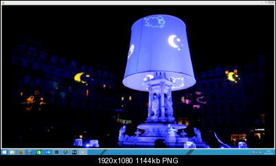

    I have a video shooted with a DSLR (Canon EOS 60D) and I have chromatic aberrations and color artifacts on sharp edges. I've done several other videos without this problem...
    Do you know how can I fix them with Vegas Pro 13 ?
    The source is AVC/H.264 1920x1080p 25 fps
    Here is a sample:
  2. These aren't traditional "chromatic aberrations" from the lens . The green/magenta "rainbows" are color moire patterns from the sensor. It's a fundamental problem on many DSLR's for video, they skip sensor lines instead of doing a proper resize , since the MP are too high for 1920x1080 and the onboard processing isn't fast enough without overheating
    It's not ideal, but what people typically do in general is apply a chroma blur to reduce the effect. Vegas has a chroma blur. And you might have to use it with masks to be more precise (other wise you degrade other parts of "good" footage)
