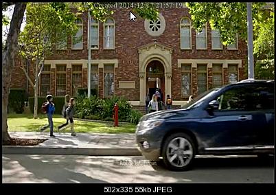

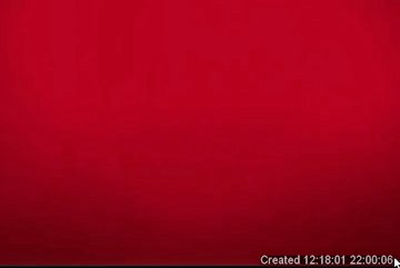

    SECOND RUN Image Produced:
    Name:  ScreenHunter_132 Dec. 24 01.19.jpg
    Anybody know why it fails on initial run?

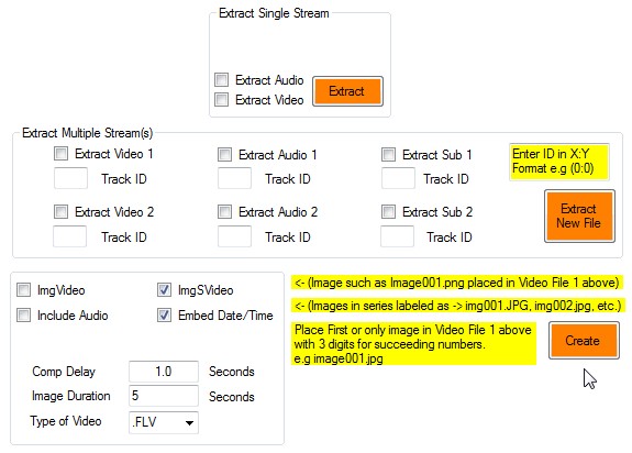

    I could never get this to work for repetitive images so I Use a GUI that builds and calls the following , with WaitForExit() and then exits the DOS/CMD screen before starting another loop.
    Thanks to everyone that helped and I used a little of each suggestion for the final result:

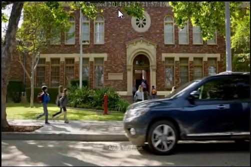

    The result is:
Name:	ScreenHunter_133 Dec. 31 01.59.jpg
ID:	29384Click image for larger version
Name:	ScreenHunter_133 Dec. 31 02.00.jpg

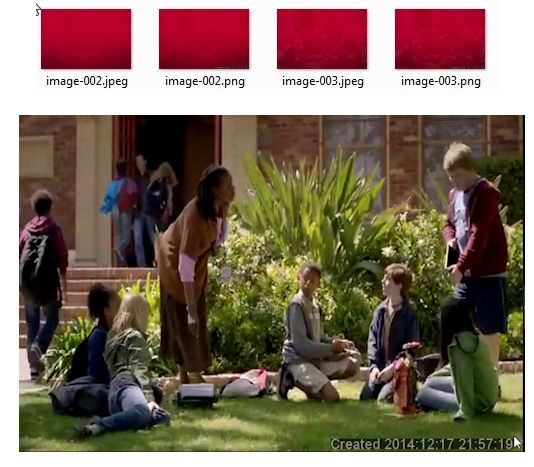

    WHoopee (Almost. this code works but I have been unable to get the results into another directory instead of intermixing into the originals. No amount of changing the final %%~dpna will get it into a folder in this path.
    for %%a in (image*.jpeg) do (
    "exiftool" -CreateDate -FileCreateDate "%%a" > single.txt
    FOR /F "tokens=1, 2, 3, 4, 5, 6, 7-15* delims=-: " %%b in (single.txt) DO (
    "ffmpeg.exe" -i "%%a" -vf "format=yuv420p,drawtext=fontfile='Arial':fontsize=20:text='Created %%e\:%%f\:%%g %%h\:%%i\:%%j': x=(w-(tw*1.05)): y=main_h-(text_h*1.2): fontcolor=white@0.5: box=1: boxcolor=0x00000000@0.5" "%%~dpna.png"
    The reason I wrote it this way is to get the output of the exiftool (File Creation Date/Time : 2014:12:17 21:57:19-06:00) into a text file that can be brought in as a variable later that would need to be parsed.
    This is as close as I have gotten thanks to all the help. Either Batch language is awfully picky or else mine is. LOL
    AND Yes I know that 3 minutes until 10:00PM is not that light out but this is an advertisement and not a video from a camera that encodes it's CreateDate. I had to settle for the FileCreateDate for testing. I pull both so if the Createdate displays on the first line, the program will use it. If both are sent to the temporary file, the batch will use the first line or TRUE CreateDate.

    nic2k4, No it makes a folder named %~dpa and then a folder inside named process and says DO was unexpected ( second one) but...
    IF NOT EXIST "%%~dpa\processed" MD "%%~dpa\processed"
    FOR /F "tokens=1,2,3,4,5,6,7-15* delims=-: " %%b in (single.txt) DO ( "ffmpeg.exe" -i "%%a" -vf "format=yuv420p,drawtext=fontfile='Arial': fontsize=20: text='Created %%e\:%%f\:%%g %%h\:%%i\:%%j': x=(w-(tw*1.05)): y=main_h-
    (text_h*1.2): fontcolor=white@0.5: box=1: boxcolor=0x00000000@0.5" "%%~dpa\processed\%%~na.png"
    Had to escape the second 'P' since CMD thinks its another path character.
    This one works Great with a New directory. Thanks very much and this will get me there!!!!
  18. Originally Posted by Budman1 View Post
    Excellent. Sorry, another slip up I forgot the backslash on the ffmpeg destination path. Good of you to have fixed it by your lonesome. Just to clear up a little bit of confusion, the \ is not an escape character for CMD or Command, it's a normal path character. The escape character is the caret ^. FFMPEG uses the backslash to escape characters, that's something unique to it.
    Also, your usage of tokens is a little bit off:
    You enumerate all the tokens from 1 to (15+the remainder), but you're only using the 4th (%e), 5th (%f). 6th (%g) and 7th (%h). 7-15 means the 7th to the 15th is one token, add the * and that says everything else that follow the 15th character is also part of that one token %h. So %i and %j will always be blank and not needed and %h could include things you don't expect.
    To properly use tokens and have full control of the results you should change the tokens statement to match only what you need and know is there. If we take the exiftool output you posted before
    File Creation Date/Time : 2014 :12:18 01:22:00-06:00
    and keep in mind that dashes, colons and spaces are delims, the 4th token is 2014, 5th is 12, 6th is 18, 7th is 01, 8th is 22, 9th is 00, 10th is 06 and the 11th is 00. In the FOR command %b is the first variable and is assigned to the first token you declare, %c gets the next and so on. Now you have total control on how you construct the text to display:
    FOR /F "tokens=4,5,6,7,8,9,10,11 delims=-: " %%b in (single.txt) DO ( "ffmpeg.exe" -i "%%a" -vf "format=yuv420p,drawtext=fontfile='Arial': fontsize=20: text='Created %%b/%%c/%%d %%e\:%%f\:%%g-%%h\:%%i'
    You can do things like change the colons to slashes for the date.

    Yes you are 100% correct and a lot of that I found the hard way. UGH! but:
    for some odd reason, %%a is used for the image name and %%b is used for the entire string in single.txt so I assumed %%c was the next I could use but as it turns out, for some odd reason again, the string File Creation Date/Time : 2014:12:17 21:57:19-06:00 gets parsed as
    %%a=File
    %%b=Creation
    %%c=Date/Time
    %%d=:
    %%e=2014
    %%f=12
    %%g=17
    %%h=21
    %%i=57
    %%j=19
    I found this by echo %%variable as I went along. Thats why my working example calls %%e as the first (2014) variable, Don't ask me why because most of the 'Normal' batch file entries caused an error.
    Luckily I added the delim of - dash and the 7-15 have delims between them so they end where I needed them. I will put my working BAT file in a safe place and then fix the tokens as you mentioned. LOL

    In order to make it work, for anyone that may be interested, with the final working version the coding is like:
    If cbCrtImgs2Vid.Checked = True Then
                strFileText = "for %%a in (""" & filepath & "\image*.jpeg"") do (" & vbCrLf
                strFileText = strFileText & "IF NOT EXIST ""%%~dpa\processed"" MD ""%%~dpa\processed""" & vbCrLf
                strFileText = strFileText & """exiftool"" -CreateDate -FileCreateDate ""%%a""  > tmpfile.txt" & vbCrLf
                strFileText = strFileText & "FOR /F ""tokens=1, 2, 3, 4, 5, 6, 7-15* delims=-: "" %%b in (tmpfile.txt) DO (" & vbCrLf
                strFileText = strFileText & """ffmpeg.exe"" -i ""%%a"" -vf ""format=yuv420p,drawtext=fontfile='Arial':" _
                & "fontsize=20:text='Created %%e\:%%f\:%%g %%h\:%%i\:%%j': x=(w-(tw*1.05)): y=main_h-(text_h*1.2): fontcolor=white@0.5:" _
                & " box=1: boxcolor=0x00000000@0.5"" ""%%~dpa\processed\%%~na.png""" & vbCrLf
                strFileText = strFileText & ")" & vbCrLf
                Debug.Print(strFileText)
                '------------write to file.bat
                Dim fnum = FreeFile()
                FileOpen(fnum, "combo.bat", OpenMode.Output)
                Print(fnum, strFileText)
                FileClose(fnum)
                '----------writing to cmd screen?
                Dim MyProcess As New Process
                With MyProcess.StartInfo
                    .FileName = "CMD.EXE"
                    .Arguments = "/k C:\Users\Bud\Desktop\MEGA_Trimmed_Tabbed_2\bin\Debug\combo.bat"
                    .UseShellExecute = True
                    .CreateNoWindow = False
                    '.RedirectStandardInput = True
                    '.RedirectStandardOutput = True
                    '.RedirectStandardError = True
                End With
                MyProcess.Start()
            End If

  20. Originally Posted by Budman1 View Post
    for some odd reason, %%a is used for the image name and %%b is used for the entire string in single.txt so I assumed %%c was the next I could use but...
    %a is declared in the first FOR command which lists all the files with a jpeg extension. %b is declared in the second FOR command and is associated to the first token in the list, thus the second token gets associated to %c... Microsoft uses %i in its FOR command help examples, so the first token goes with %i, the second %j...
    ... as it turns out, for some odd reason again, the string File Creation Date/Time : 2014:12:17 21:57:19-06:00 gets parsed as
    %%a=File
    %%b=Creation
    %%c=Date/Time
    %%d=:
    %%e=2014
    %%f=12
    %%g=17
    %%h=21
    %%i=57
    %%j=19
    this batch would produce those results
    FOR /F "tokens=1,2,3,4,5,6,7,8,9,10 delims=-: " %%a in (single.txt) DO (
    ECHO %%a
    ECHO %%b
    ECHO %%c
    ECHO %%d
    ECHO %%e
    ECHO %%f
    ECHO %%g
    ECHO %%h
    ECHO %%i
    ECHO %%j
    %d being a colon is the result of another interesting feature, when consecutive delim characters are found in a string only the first one counts the rest get treated as regular text up to the next delim that precedes more regular text. To account for that what I posted before should be changed like this
    FOR /F "tokens=5,6,7,8,9,10,11,12 delims=-: " %%b in (single.txt) DO ( "ffmpeg.exe" -i "%%a" -vf "format=yuv420p,drawtext=fontfile='Arial': fontsize=20: text='Created %%b/%%c/%%d %%e\:%%f\:%%g-%%h\:%%i'
    Delims don't influence the tokens they delimit group of characters in the string that results from FOR processing what's IN the brackets (). I had not played with batch files in a long time it's been a fun review for me.
