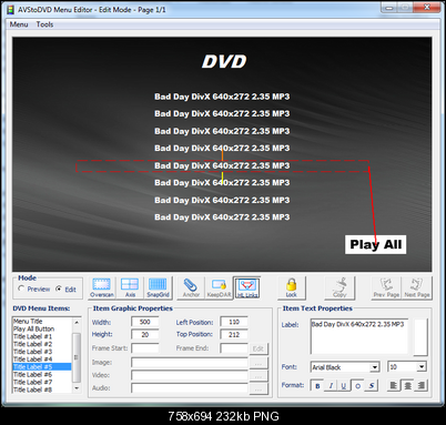

  3. @gastrof
    in 'Menu Editor' section, you can preview the link between menu titles. Click on the 'HL Links' button, then play a bit with the thumbs by moving them in the screen.
    Check if there is any discrepancy between the 'Menu Editor' setup and your DVD remote controller response.

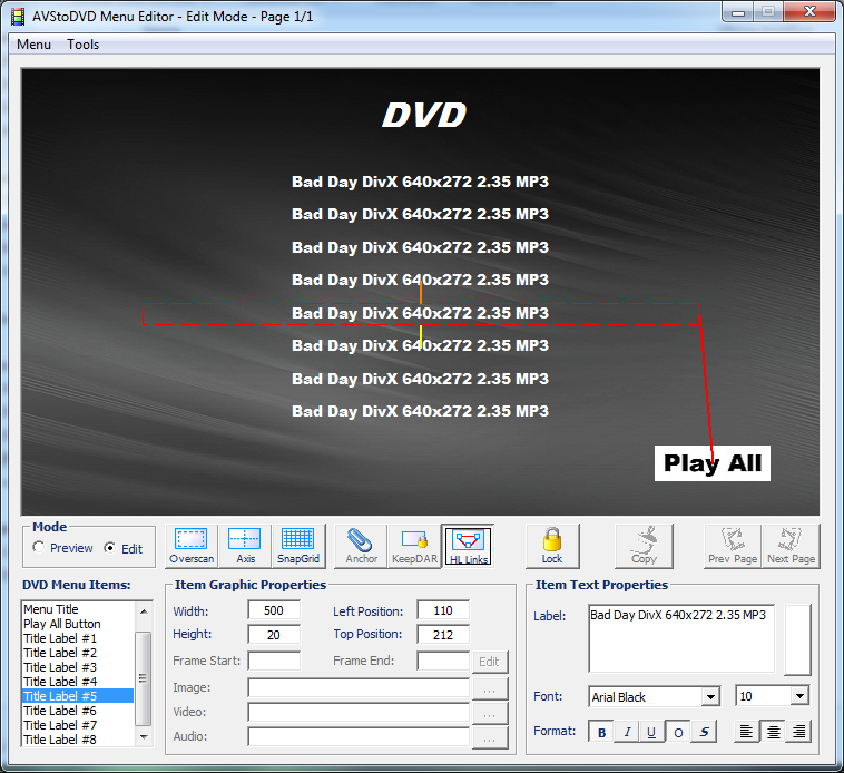

  9. @gastrof, no problem, we are here to understand together.
    Your DVD Menu Editor page should hence appear like this:
    From title 5 you should be able to go to title 6 (remote controller arrow down), or to go to 'Play All' button (remote controller arrow right), or to go to title 4 (remote controller arrow up).
    Please check and advise.
    Bye
    MrC
    AVStoDVD Homepage

    Yeah, your picture well illustrates what I was dealing with, but the problem is the arrow buttons wouldn't let me step down from the 5th to the 6th title. It jumped to "play all".
    I did carefully put each title the same distance from the ones above and below, so it's not like 6 was too close to 5, or the others were too close to each other to allow the "arrow steps" to work. The first five worked, not the last three.
