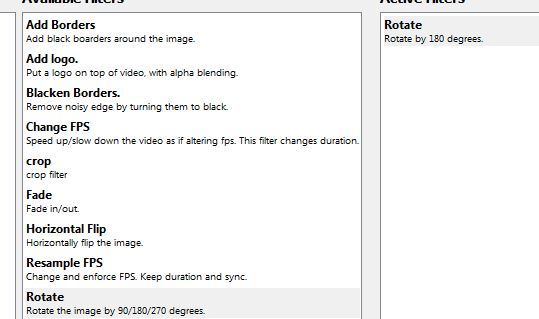

    Try AVIDemux. In filters there is a rotate option. You will have to re-encode to rotate, so there will be some quality loss. You can also use a different codec there if desired.

    Thanks. But think I am missing something. Please select the image. After selecting the Rotate to any angle, How to convert to apply the change?
    I am just saving, but its just remaining unchanged...

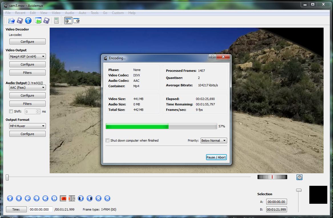

    You have to re-encode for any filter to work. Select your format, audio and video and filters and encode. I've fixed several videos that a friend recorded with his phone and the phone didn't flip it correctly. Here's one I did for a sample. I converted a .MOV video with PCM audio to Xvid with AAC audio. It did flip it over and it looks OK.

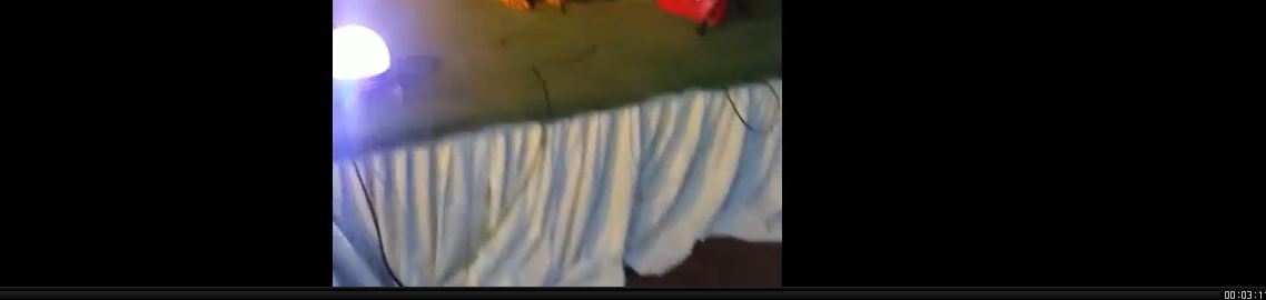

    I did 1 file with AVIDemux. It worked, but just a final thing need to assure. When it finish encoding with rotation, vertically the clip just shrinking in size (width). So is there any way to fix the width/Frame?

  8. Use the crop filter. It's visible in the screenshot in post #3

    You can also SEE what the outcome will be by playing with those two switches just below the word AUDIO as shown in the screenshot.
