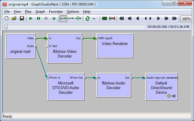

  14. There are two issues: how VirtualDub gets access to A/V files it doesn't natively support, and how Windows gets access to A/V files it doesn't natively support.
    Since VirtualDub doesn't natively support MP4 files it needs a plugin to open them. There are at least three input plugins for VirtualDub that can open MP4 files: DirectShow, ffmpeg, MPEG-4. I used the first of those three, the one you linked to in your last post. That gives VirtualDub the ability to open any A/V file that Windows' DirectShow (a modular, extendable API for dealing with audio and video, the system used by Windows Media Player) can open. When you open a video file in VirtualDub you can specify which source plugin to use via the "Files of type" pulldown on the Open Video File dialog. If you don't specify which to use, and you have multiple plugins that can open MP4 files, VirtualDub will pick one for you.
    But Windows' DirectShow system doesn't necessarily know how to open Mp4 files (depending on what version of Windows you're running). DirectShow needs a source filter in order to recognize the MP4 container as a media file, a splitter to separate audio and video (and other) streams, and then decompression codecs to decompress the audio and video. So you may need to install DirectShow source filter for MP4, a splitter filter for Mp4, and codecs in order DirectShow to open MP4 files.
    It can be hard to tell exactly what components are being used by DiretShow. What's used will depend on what filters you have installed and their priorities. Using GraphStudio to open your video shows the following graph on my computer:
    The source filter (on the left) is Haali. That acts as both a source filter and splitter for MP4 files. The output of that filter is routed to ffdshow for video decoding and (via the DTV/DVD audio filter) ffdshow for audio decoding. Finally the decompressed video is sent to the graphics driver (Video Renderer) and the decompressed audio to the audio card (DirectSound Device). When opening the file in VirtualDub the decompressed audio and video are sent to VirtualDub rather than the output devices.
    DirectShow should be the method of last resort for opening A/V files in VirtualDub. What you get will depend on what's installed on a particular system. And DirectShow isn't necessarily frame accurate. What frame you get may vary depending on whether you decode the video linearly or seek through it randomly. And since your video is variable frame rate, and VirtualDub only handles constant frame rate, there may be problems with that. In my case, Haali (I believe) is reporting the video as 25 fps because the video is VFR and it has to tell VirtualDub something.

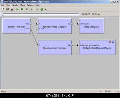

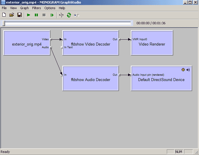

  15. jagabo you are really helping me a lot. Now I understand why 3 icons are shown in my taskbar (haali, ffdshow audio and ffdshow video).
    Now I know that some frames get lost (yes, I have learned how to install and make work the filter and how to open the video via ffmpegsource-avisynth and it reports 29,6 frames while opening it via DirectShow seems to be 25fps).
    I have Installed Haali too. This is how the video looks like:
    Only thing its strange for me is that I can open the video in Virtualdub via ffmpeg-source + avisynth. But cant open it in Media Player Classic the same way (with the same .avs script)

  18. Originally Posted by DogDay View Post
    by the way: in your GraphStudio screenshot it seems you decode audio twice, first with MS DTV-DVD audio decoder and after that with ffdshow audio decoder dont you? Why?
    MS DTV-DVD audio decoder inserted itself for custom channel mapping. It's possible to bypass that filter and route the AAC audio directly to the ffdshow.
