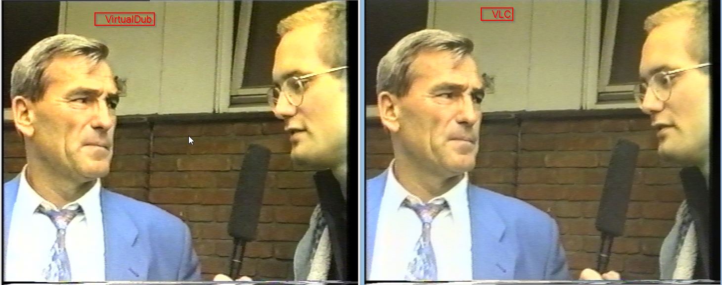

    i may have one more problem, more related to virtualdub i fear. When i open my soccer video in virtualdub and vlc there is quite a difference in color levels / saturation especially when looking at people faces:
    [Attachment 29184 - Click to enlarge]
    It has less to do with VirtualDub and mostly to do with your source. The way different media players treat colors and levels is another story altoget5her, but the color in both images looks dopey. Mainly, your black levels are too high and chroma in the images as well as your original sample is seriously clipped at the bright end. The guys in both images look orange: too much bright red and green, and blue has serious problems. Because of clipping, dynamic range and color correction in brights and skin tones is impaired. Your original, images don't look oversaturated, they look off-color and washed out.
    You have to correct in YUV first. Your earlier avi sample appears to have been captured as too bright.

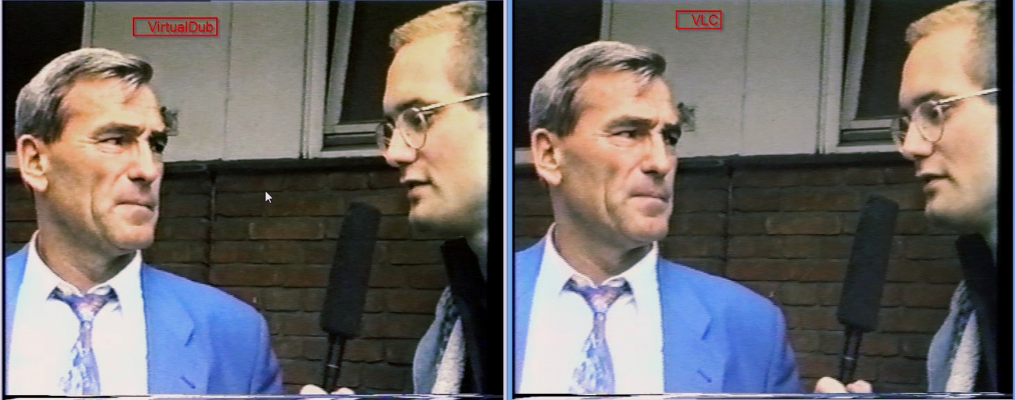

    With high IRE and chroma clipping, there's not much one can do. In the "correction" below you can see that even if you bring black levels down and try to lighten brights, the bright end lacks brilliance and looks washed and skin tones won't ever look quite right:

    ok thanks for the input again! i will try to make the most of it. Maybe someone magically finds those original master tapes again (which i highly doubt)

    Could try a sample from your original AVI's YUV colorspace, saved in VirtualDub with "direct stream copy" to avoid RGB conversion and clipping. It's possible to rescue a lot of detail using the original, not a converted clip.

  19. VirtualDub always uses a rec.601 matrix when converting YUV sources to RGB (usually correct for SD, wrong for HD). Most media players will use whatever matrix is flagged in the video, or in the absence of a flag will use rec.601 for SD, rec.709 for HD (both of which are usually correct). Media players may also perform other processing either explicitly with their own settings or implicitly via the graphics card's settings.

    here is a direct stream copy sample. Thanks alot for the technical input, really appreciate it.
    May 2014
    Memphis TN, US
    Thanks, opticum, a more workable sample. Not much work for skin tones here, but same basic problems of high gamma and black levels, and brights blown out. It appears to be on the original tape dupe (no surprise), but also looks as if brightened more during capture (again, no surprise). So, making corrections won't relieve clipping loss entirely. But level corrections can rescue some bright details, preserve more dynamic range, and give the images more perception of depth if conversion to RGB display is managed more carefully by fixing things first in YUV. Dozens of ways to do it -- basically lower gamma (black levels) and try to keep bright colors from smashing against the right-hand side of histograms.
    I used the code below but there could be many variations:
    ColorYUV(cont_y=20,off_y=-5)
    ColorYUV(cont_v=-20,gain_v=-5,cont_u=-15)
    Levels(12, 0.95, 255, 16, 250)
    Tweak(sat=1.2,coring=false)
    Also cropped off excess borders and got closer to real 4:3 DAR by keeping frame size to 704x576 for SD PAL. BTW, sample2 has far less levels and chroma damage than the earlier avi or the images posted in #15. Luma in this one is within 16-235 margins, but chroma somehow got shifted upward and shoots past 235.
