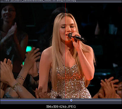

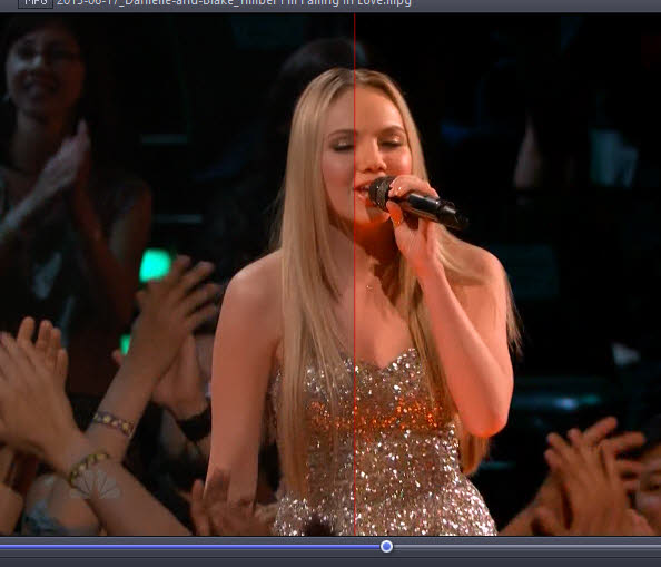

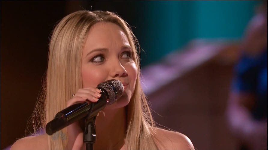

    Here's a comparison of of what I believe is the identical video frame being presented by PotPlayer 1.6.49952 64-bit and also by Windows Media Player. Sapphire DDR5 AMD R7 250 video card, running latest Catalyst Omega 14.12 driver, Win7 Pro x64. Eizo S2433W 24" LCD monitor.
    Look at the difference in the rendering of the out-of-focus background guitar player in the upper-left corner. Night and day difference in the two presentations.
    The video being played is an edited MPG clip (using VideoRedo) of a WTV program recorded by Windows Media Center. There is zero re-compression done by VRD into the MPG clip via fast-frame-copy. So the MPG clip is simply the new wrapper format (instead of WTV) for the identical bit-perfect copy of the original underlying HDTV program content which is MPEG-2 recorded from OTA/ATSC antenna via Hauppauge HVR-2250 TV tuner card and WMC.
    As you can clearly see, there are two VERY DRAMATIC DIFFERENCES from the two players:
    (1) The image produced by WMP is DRAMATICALLY SHARPER than the image produced by PotPlayer. This is truly dramatic, and almost inexplicable. But why is WMP so much sharper and better and clearer. It is very noticeable, especially when looking at the hair on people's heads that is blond. In the following image there is a single blond hair standing up at the top of Danielle's head, which is clearly visible in the WMP rendering but is almost not seen in the PotPlayer rendering.
    (2) There is a definite color difference in the rendering by the two players. This is easy to see in the above two screenshots.
    And again, notice the easy-to-see difference in the out-of-focus backup guitar player on the right side of the the frame in the above image.
    So, my question is simple: what can I do, if anything, to improve the presentation by PotPlayer? Should I be using external filters or change the rendering setup, and if so what specifically do I need to do?
    Is the built-in default PotPlayer mechanism so clearly inferior to that of WMP? Do I need to change the decoder setup, and if so what do I need or what should I try? Do I need to activate FFDSHOW or not? What about DXVA or not?
    What is the explanation for the above differences, and what can I do to improve how PotPlayer plays MPEG-2?
    PotPlayer experts, please help.

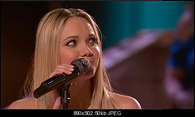

  6. I find no differences. windows 8.1 x64, HD 7850. What kind of video renderer are you using in potplayer?
    WMP (EVR)
    Potplayer (EVR-CP)

    Well... I was correct, in that the issue with sharpness apparently was related to deinterlacing and how the two programs do it.
    And you were correct, modifying both of PotPlayer's deinterlacing method option boxes to use "use hardware deinterlacing" rather than "use software deinterlacing" magically made all the difference in the world!!!
    I think you'll agree that these two images are essentially identical now.

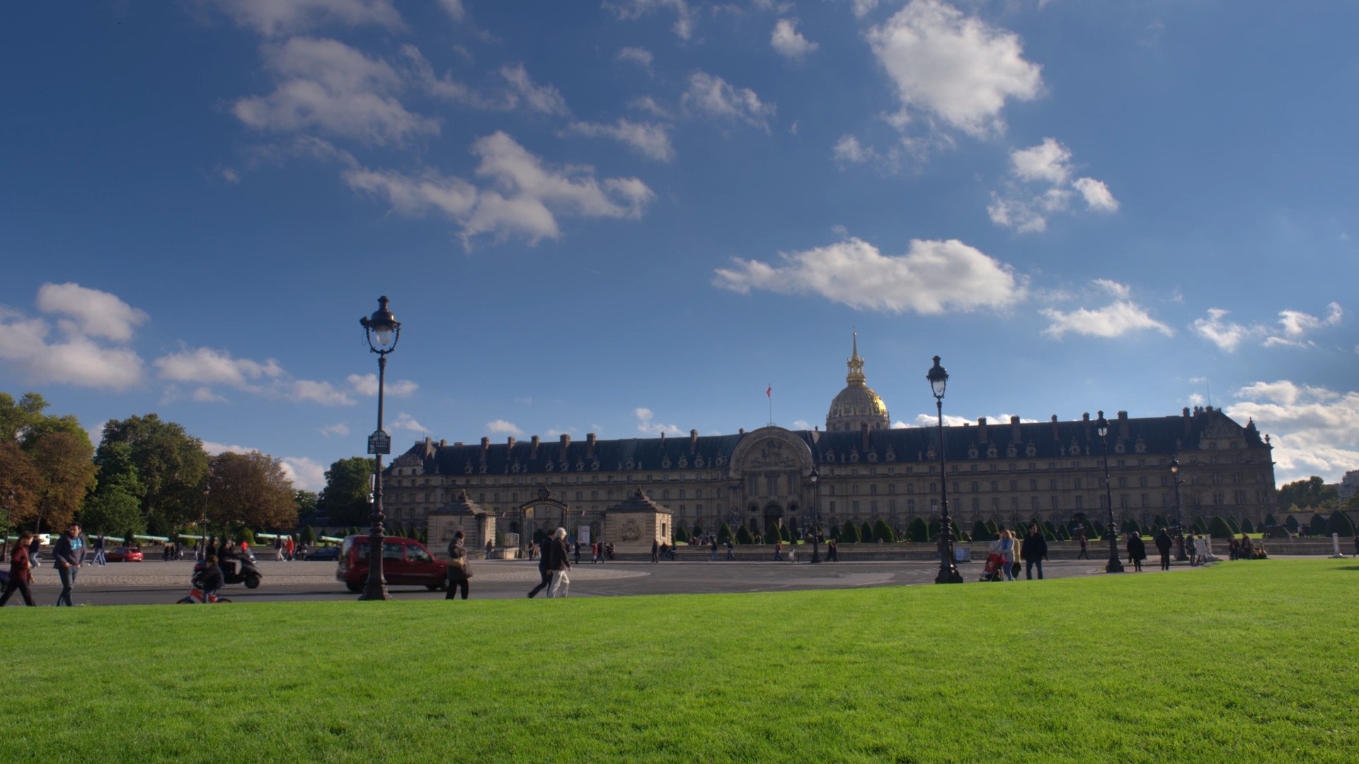

  23. i did, but there was no difference (video still blurry just like the OP). but i dont think my video utilizes deinterlacing so its a different cause. i suspect its something weird with my filter setup but I'm still very confused.
    WMP and MPC are both very sharp (see attached) , where as Pot player, KMplayer are blurry . All settings are default.
    this is the video sample i am using: http://www.demo-world.eu/download-2d-trailers/?file=sony_paris-DWEU.mkv&pic=sony_paris.jpg
    it is most notable in the grass and the tower in the scene in my attached, please view photos in original 1080p size
    **one thing i suspect, is that MPC is using LAV decoder. is that the cause..? UPDATE: nope, tried installing LAV filter and set to use LAV splitter and video decoder. no difference in sharpness..

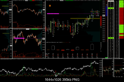

  27. i have the same problem with sharpness in potplayer and no matter what i do, nothing changes
    here is the difference - first screen is pot player (blured), the other is camplayer (sharp)
