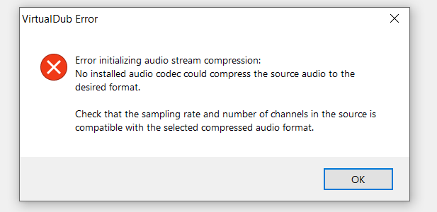

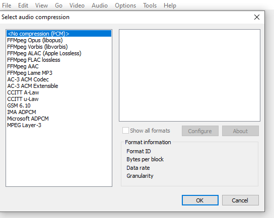

  12. Gelinox I wonder if you can resolve this problem please
    I am trying to process a 5 minute sound mp4 video file.
    No matter if I set it to mute audio or choose any of the audio choices for the .mov output I set up, I get this error before beginning any settings
    [Attachment 56182 - Click to enlarge]

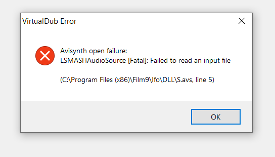

    Adding another mp4 file with sound, and choosing mp4/ mp3 or aac output, I get this error when I hit RENDER, if I set it to silent, it works.
    [Attachment 56183 - Click to enlarge]

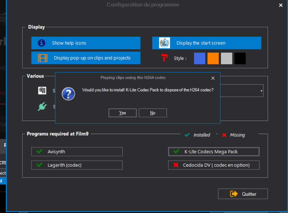

    I have the K Lite codec pack installed windows 10 is that the problem, should I have the mega pack, it warns me I will lose the H264 codec if I install it
    [Attachment 56184 - Click to enlarge]

    Hi super8rescue, I installed the mega codec pack (1587 Mega) anyway seems to work for me. There is an update since then.
  14. Thanks Andy M
    It turns out I do have the mega pack installed, I only looked at the start menu so I didn't see the full name
    [Attachment 56185 - Click to enlarge]
  15. Thanks to AndyM for his advice, it is indeed the right thing to do.
    Now I am not sure if this works for Super8rescue.
    If not, it is a problem of parameters with KLite, choosing the default options, without modifying them, it works.
    I don't think you have to worry about losing your MP4 codec as you advertise Klite.

    Thanks Gelinox. I will unistall the Klite version I have, and retry using the icon in Film9 to replace it.
    I will run a sound film over the weekend and let you know if it works.

    Hi All
    I get exactly the same errors, no matter what type of file I am trying to restore. I end up having to extract the audio, any help with this would be useful, as the software really does a great job of cleaning old footage, it just doesn’t seem to like any of the audio formats. I have installed the codecs using the film 9 software. So not sure why it doesn’t work. Hope someone can help, or explain what audio formats the files need to be, as it doesn’t mention it in the guide.
    Cheers
    DMS
  23. Hi DMS
    Since I posted that error message, Film9 seems to be working for me now with audio.
    I can't explain why.
    Sorry I can't give you an explanation other than the update to the codec pack as mentioned by Andy M 'may' have been of help in my case.
  24. VirtualDub is missing some audio codec which should have been activated by the default installation of KLite megapack.
    I am attaching Gilles answer to you, who has already answered a user who had the same problem:
    - You launch Virtualdub with Film9
    - You go to the "Audio" menu and check "Full processing mode"
    - Go back to the "Audio" menu and click on "Compression"
    - You now have an Audio codec list.
    [Attachment 56715 - Click to enlarge]
    Compare this list with the audio codecs you have.
    Reinstall K-Lite MegaPack by selecting the missing codecs.
    Ragards.
    Ragards.
    Hi Gelinox
    Thanks for this info, it didnt work to begin with, but i have just updated to the latest codec mega pack and it is now working, thanks for your help.
    Cheers
    DMS

  26. im getting this issue everytime i try to do anything with a mp4 file

  27. Hello,
    There was a previous installation of Avisynth before the installation of Film9.
    You must uninstall Avisynth completely, including the "avisynth.dll" DLLs located in the "System32" and "SysWov64" directories (if present).
    Then go to the "Preferences" menu of Film9 and click on the "Avisynth" button.
    Do not change anything in the default installation parameters.
    Regards
  28. Originally Posted by Gelinox View Post
    Hello,
    Regards
    Thank you very much .... works perfect now .. happy days
