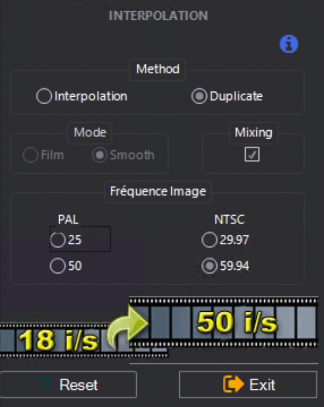

  1. Dears,
    I'm new to this software so I'm running some tests.
    Just one problem with interpolation:
    [Attachment 44821 - Click to enlarge]
    With and settings the output is just speeded up, three's really no interpolation.
    Input is a 3 minutes file at 18 fps, output is a 1 minute file at 60fps.
    Any suggestions?
    Tks a lot.

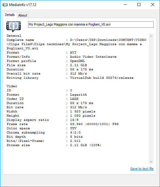

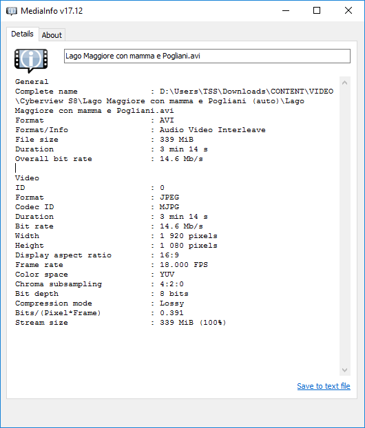

    Dear,
    I heard about that Synchro but I can't find it: where is it exactly?
    About the files, this is the input:
    [Attachment 44826 - Click to enlarge]
    And this is the output:
    [Attachment 44827 - Click to enlarge]
    Thank you so much.

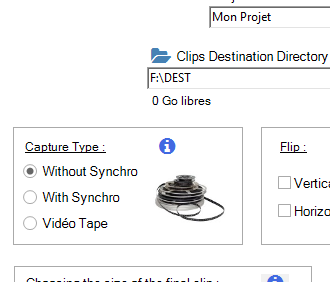

    You have a special tutorial "Projects" in the Menu "Help"
    [Attachment 44828 - Click to enlarge]
    For Open Projects Window
    [Attachment 44829 - Click to enlarge]
    To Choice the Synchro
    [Attachment 44830 - Click to enlarge]
    And multi-Infos in the Blue Icons "i"
  5. Originally Posted by GillesH View Post
    Thank you so much, sync solved the problem.

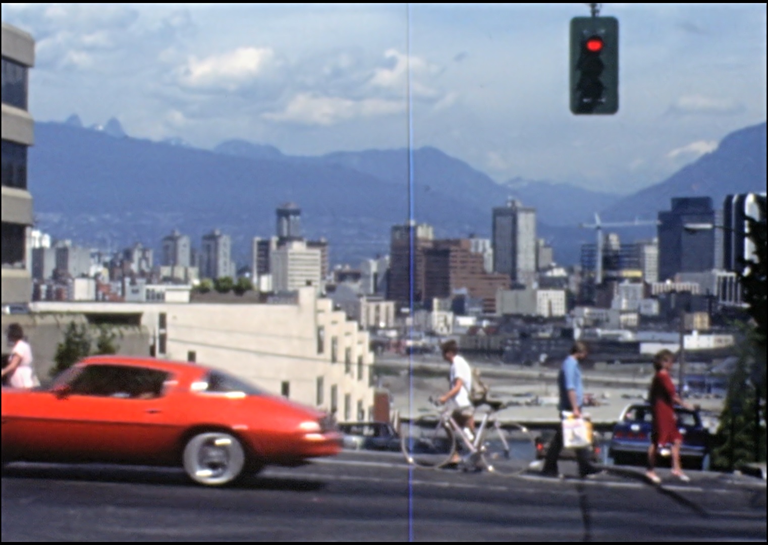

    As this software deals with old films and is based on Avisynth: Can this be implemented in the workflow (as it is also done with avisynth)?
    http://avisynth.nl/users/fizick/descratch/descratch.html
    On my recenct footage I have some rather obstrusive scratches (fortunately not throughout the whole film but only parts). After processing with Film9 that does some very good job otherwise those scratches are not fixed. For 8mm films such scratches are not uncommon and it might fit the software to deal with them. What do you think? Is that feasable?
  27. Originally Posted by mcconnor View Post
    You can try it by just running a section of your film through a standalone AVISynth script. However, having tried this myself many times, I doubt you will get much help. Scratches are really tough to remove automatically because they are almost constant from frame-to-frame, but not quite perfectly constant. They tend to wander horizontally and also grow and shrink vertically. Thus, unlike dirt spots which exist for exactly one frame, they cannot be removed by looking for a certain-sized artifact from one frame to the next and then removing anything that only exists for one frame, and they cannot be removed using a "de-logo" algorithm that is used to remove static bugs and other types of logos and timestamps that are perfectly stationary.
    There is a way to remove scratches that works really well, but you have to do it at the time of the transfer. It is called a "wet gate" transfer and it involves applying a thin solution of slightly viscous fluid to the film prior to the transfer. It fills in the scratches and they completely disappear. You can Google "wet gate transfer" and you'll find lots of explanations along with excellent before/after examples.
