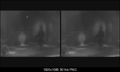

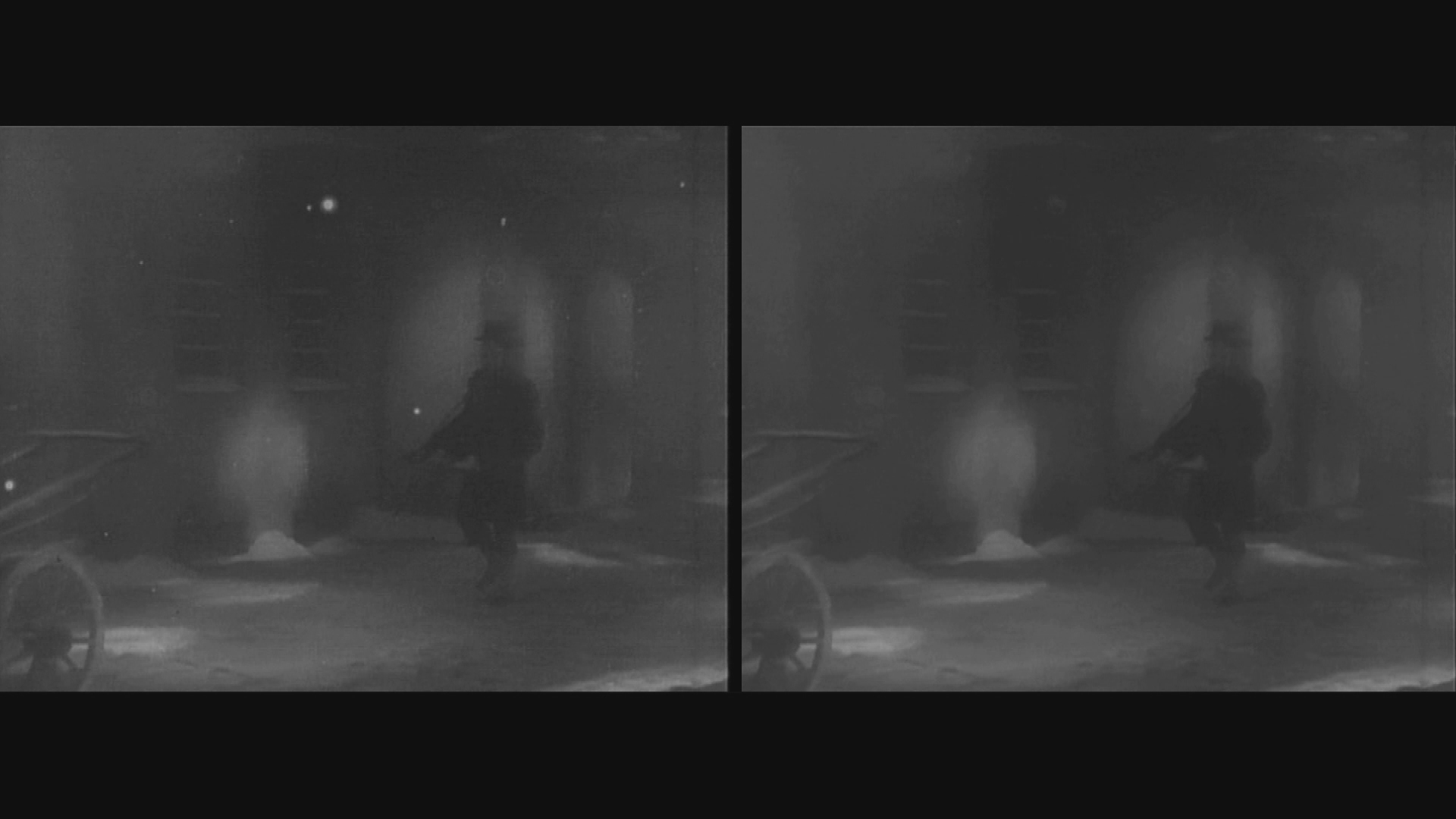

  16. Here`s my results from the new film Dirt cleaner
    http://www.infognition.com/dirtcleaner/
    The Splitscreen result with default settings in virtualdub.
    I think its not bad, Obviously the image is softer- but The same applies for most other plugin scratch cleaners.
    I haven`t done any sharpening or grain removal to the splitscreen video.
    I notice there`s a brightness difference on the processed video and i suspect that happened somehow in the flaky Pinnacle studio when i made the splitscreen, The difference wasn`t there from the virtualdub export.
    heres are the original and splitscreen result video

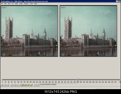

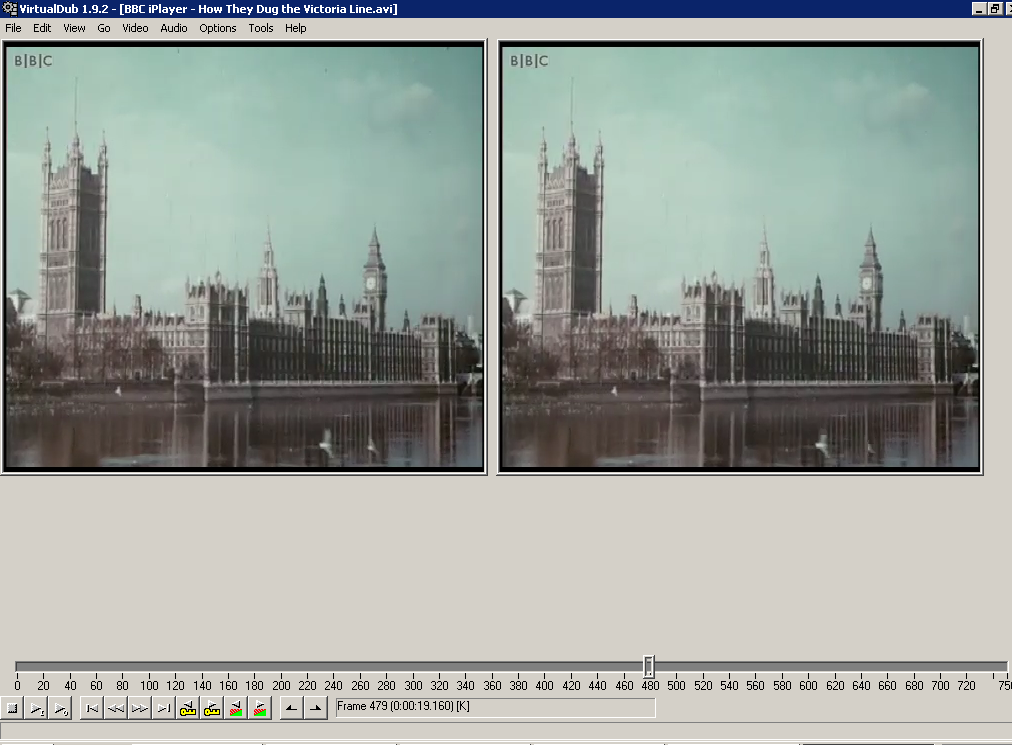

  18. Re Flying Birds JohnMeyer, Yes you are quite correct it damages moving objects, heres a nice clip which demonstrates this.
    The birds wings get clipped!
    Frame 479
Name:	Flying Birds.png
    here`s the clip if you fancy trying it with your excellent script.
  19. No need to try it: I'm sure it will make them disappear entirely!

    Polavision RemoveDirtMC Before/After
    One of the biggest problems is that the dirt isn't pure black or white, and also the dirt spots are so numerous it is hard to find clean areas in the adjacent frames to help fill in the dirt spot. It was quite a chore to achieve this dirt reduction. What is amazing about RemoveDirtMC is how it is able to leave intact structures like the bars on the bird cage, or the chain link fence behind the children. (And, the other functions in my version of VideoFred's script are still able to bring out the detail in the chain link fence, despite all the dirt!)

    Here's a short example, with the "before" next to the "after," just like manono's clip:
