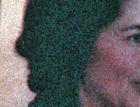

    any ideas how to get rid of a grain turned blue like this?
    [Attachment 68560 - Click to enlarge]

  3. @ultradj83: if you are working with an image use an image editor. For a video, posting a still image doesn't say much of the characteristic of the noise.
    -> attach a short (few seconds) sample of your source.

    Hi there.
    Well,
    I'm using Film9 to restore a 8mm film, which is actually a stripe of jpg frames.
    Regards

  6. Originally Posted by ultradj83 View Post
    Dears,
    Regards.
    Have you tried the filter CCD it's a vdub filter but can be used in avisynth (film9 use avisynth ?)

  7. Originally Posted by ultradj83 View Post
    Dears,
    Regards.
    Hard to say without seeing more of the frame. It might be that the blue channel is cranked up to high (relativly) - perhaps only in the dark tones. I had a similar problem throughout my canada restoration project (https://www.youtube.com/watch?v=OulrI4yaz64) and solved it quite accceptable with a reduction of the blue channel in the shadows but not in midtones and highs.
    I see you did quite a good job.
    Thanks for suggestion.
    Just to share, I see there's also chance to use AI for restoration and upscaling.
    I prepared a RTX powered workstation on AWS to check this, by the way I need to engineer a workflow for to merge Film9's filters and upscaling features with this.
    It's all new to me, so at the moment I am only proceeding by attempts...
