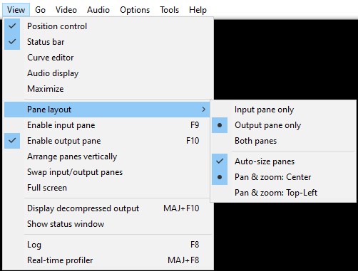

    Just a point, it's easier to configure VirtualDub this way, so you don't have double windows constantly appearing.
    [Attachment 66748 - Click to enlarge]

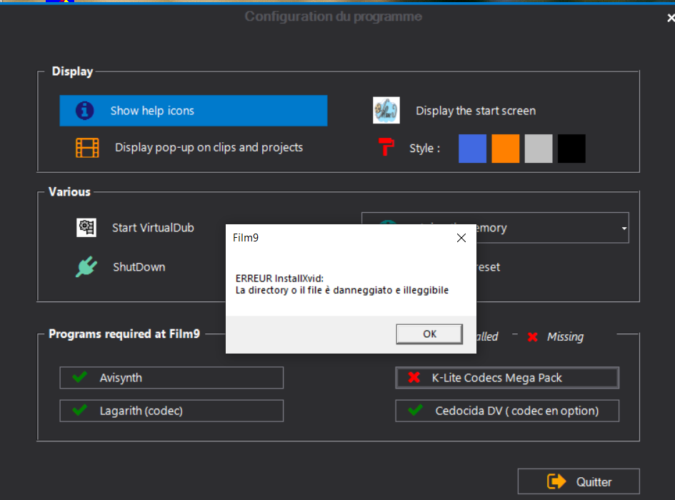

    Hello everyone, I need your help.
    I'm a big fan of Film9 and I used the old version quite happily until the day before yesterday.
    I saw that there was a new update and downloaded it but I can no longer use it.
    Before installing it, as I read, I uninstalled Avisynth and reinstalled the K-lite codec full pack, but in the preferences it marks it as "missing" and if I try to import an avi movie I get the alert that the codecs are missing.
    Does anyone know what kind of check I need to do?
    Thank you very much

  21. See next post for the answer.
  22. Some precisions :
    - It is essential to install the K-Lite MEGA pack and not another.
    - This pack is not attached to Film9, so you have to download and install it
    - This pack was available on the Film9 site, now this site is closed, which explains the error message if you go through Film9 for the installation.
    - No need to go for an old version of K-Lite Mega Pack, the new one works.
  23. Member
    Dec 2022
    itaky
    Thank you so much! Now is working

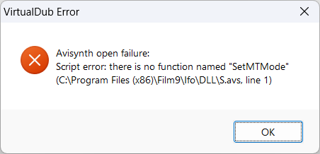

  25. Dears,
    does anybody know how to fix this?
    [Attachment 68543 - Click to enlarge]
    This happens when VirtualDub is launched upon adding any clips to any projects.
    Regards
  26. Video Restorer lordsmurf's Avatar
    Type the middle line (script error: ... ) into Google. Odds are you'll find yourself at Doom9, VH, or digitalFAQ. Common issue, easy to fix. I just don't remember it offhand.
    That is an Avisynth issue.
    It has nothing to do with VirtualDub.
  27. Originally Posted by lordsmurf View Post
    Right, fixed by installing Avisynth by Film9.
    By the way now I have all output frozen on 1st frame.
    Input is a stream of jpg files, I might be doing something wrong as clicking play on input or output video nothing moves...
    Thanks!

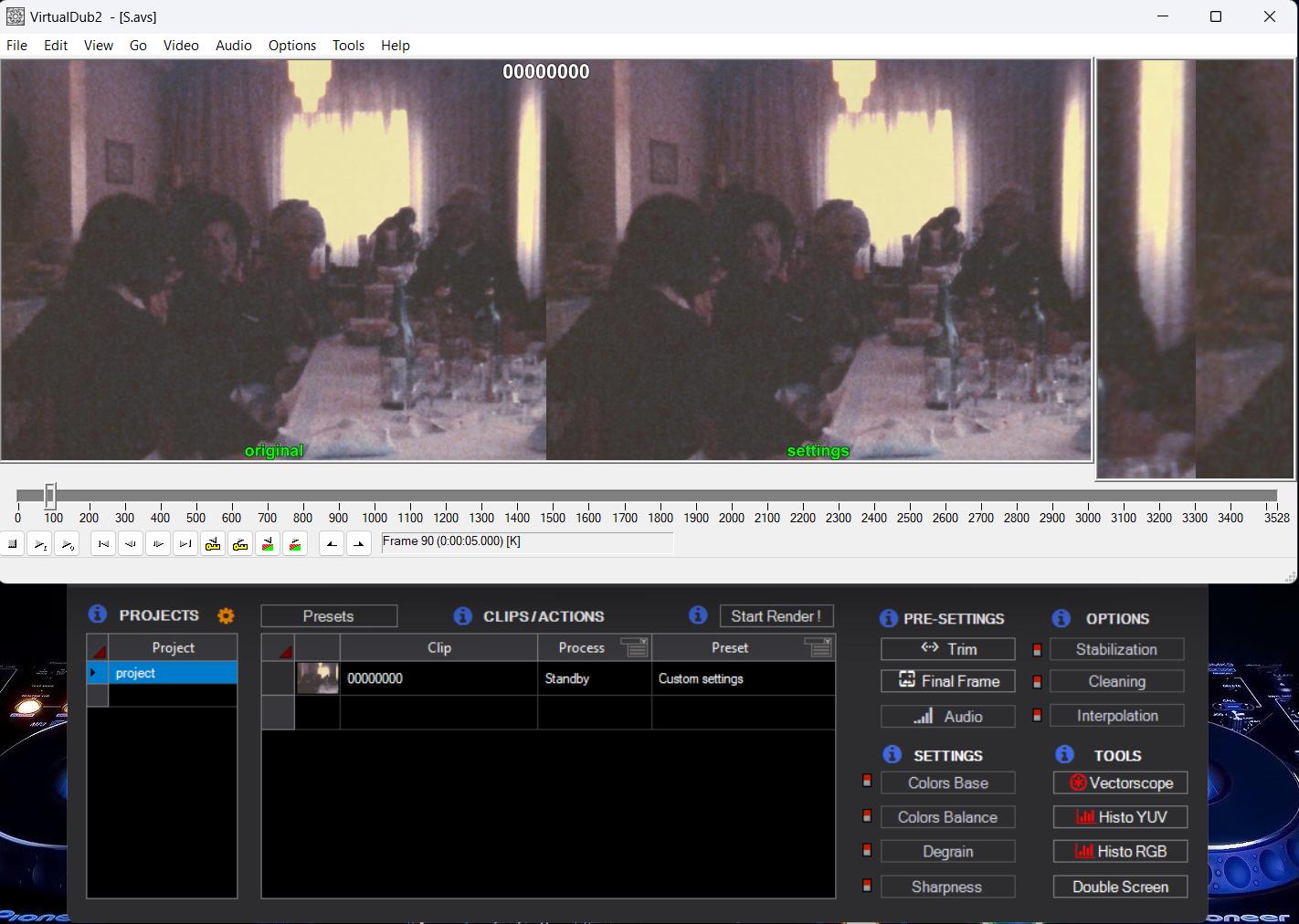

  28. Dears,
    I'm facing a big problem rendering to any format a few thousand frames in jpg format.
    Also "as it is" (with no settings and no presets) virtualdub reports the right number of frames (3528), but clicking anywhere on the timeline (and also in the render), it's only the 1st frame to be shown duplicated 3528 times:
    [Attachment 68557 - Click to enlarge]
    Any suggestions?
    Regards
  29. Hello,
    First, you can read the post of 13th Sep 2022 09:00, which will prevent you from having a double display on VirtualDub.
    Then for your problem of JPG images:
    - Do you have a chronological numbering of your files, without missing number?
    - Try copying 20 images into a new directory, starting with image 0000001.jpg and making sure that none are missing.
    Ragards
  30. Originally Posted by Gelinox View Post
    Hello,
    Ragards
    Got it.
    It just doesn't like the 000000.jpg as 1st frame, it must start with 000001.jpg.
    Thanks a lot.
