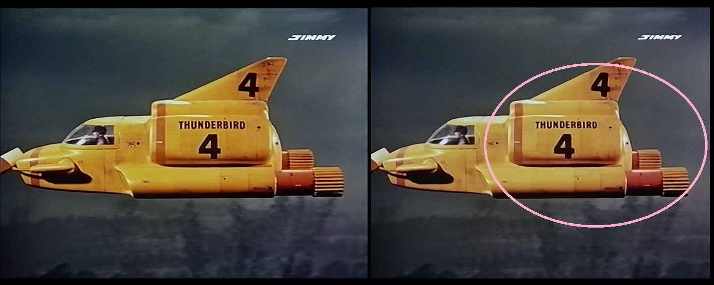

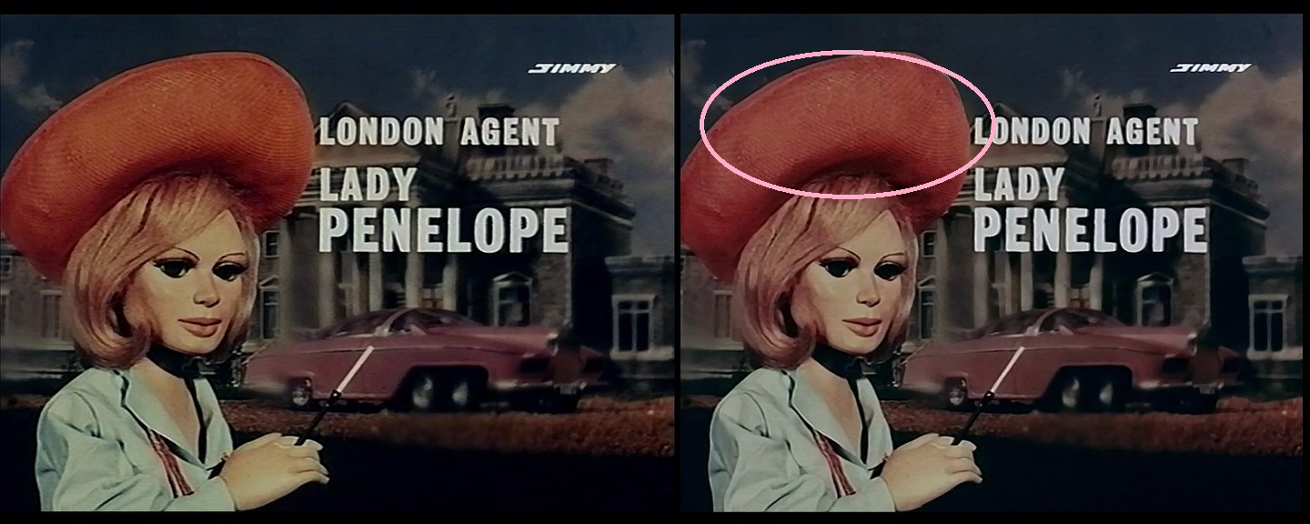

    [Attachment 65081 - Click to enlarge]
    [Attachment 65082 - Click to enlarge]
    The script I used uses only few lines and is very simple:
    "levels and colors correction before filtering"
    StabMod()
    TemporalDegrain2()
    LSFmod(ss_x=1.5, ss_y=1.5, secure=false, Spwr=2, SdmpHi=0, soothe=false, keep=25, edgemaskHQ=true)
    "levels and colors correction after filtering"
    In any case, thanks for your effort, a comparison of different methodologies is always constructive! I leave to the other users further comments

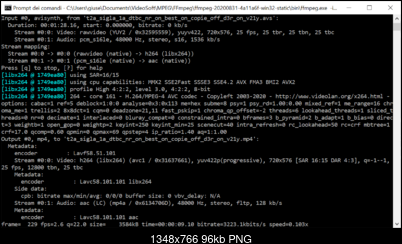

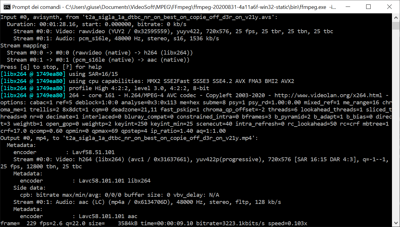

    On my laptop Asus ZenBook UX530UX-FY033R, Windows 10 Pro that script runs at ~3 frames per second to generate a HuffyYUV output through VirtualDub.
    If feeding ffmpeg with the avs script to compress to h264, with
    ffmpeg.exe -i t2a_sigla_1a_dtbc_nr_on_best_on_copie_off_d3r_on_v21y.avs -c:v libx264 -crf 17 -preset slow -aspect 4:3 -c:a aac -b:a 128k t2a_sigla_1a_dtbc_nr_on_best_on_copie_off_d3r_on_v21y.mp4
    it runs at ~2.6 frames per second

    I showed some detail loss in the pictures I posted (within the limits of mp4 compression first and jpg later). Your second clip is shortened, no major difference there in term of details, but do you seriously prefer your results to mine? You must be biased ad well
    I will leave more comments to others, this time for real I promise!
