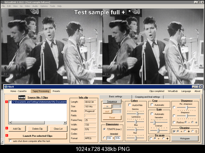

    As you see there are additional artfacts in the grain on the grey wall,this is with no cleaning applied or boxes checked.

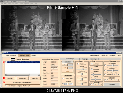

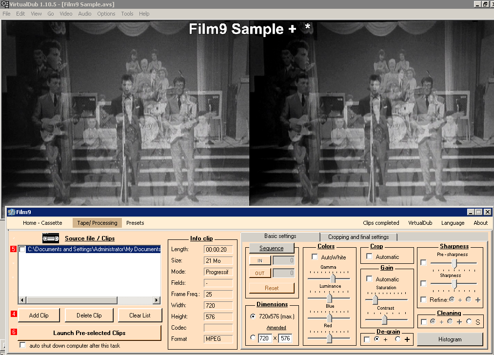

    Here is a sample of film9 cleaning,Notice the big spot almost removed on the arm, This is with the minimal + box checked
    There is no way on earth "Vreveal" could fix that!

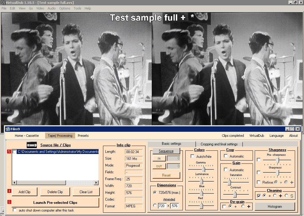

    Thanks John for your work on this clip, I like your results as they retain more detail than my current methods, My workflow is convoluted and although I`m not a complete noob i have a lot to learn from you guys.
    I had a go at trying to lessen those interference/telecine lines with this VirtualDub plug called "2D Comb" Then i ran it through QTGMC in progressive mode 1
    http://www.cithraidt.de/filter/index.html#2d_comb_1
    Heres my restored version below
    @ Gilles Re Film9
    Its would be great if you could add a additional option to disable the initial light Degrain/Deband,this would make Film9 very useful for me, The banding on certain clips is the only reason i cant use Film9 for now,

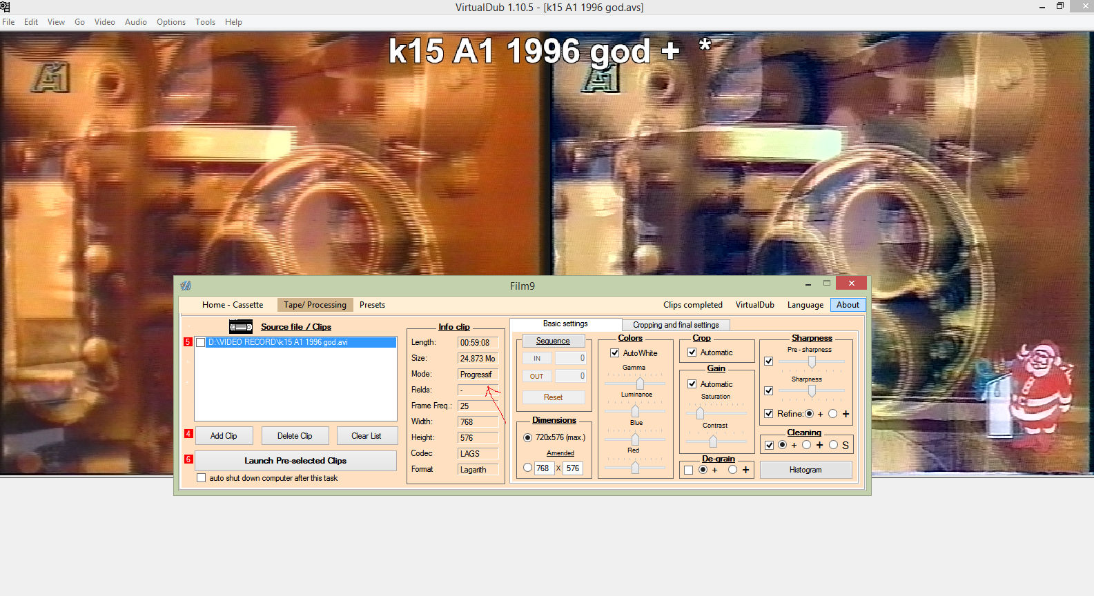

  15. mammo1789:
    Film9 accept not only progressive file. If you have problem with file format, you can send us a sample of your video so that we can test it.
    Even with new version all lagarith and ut interlaced TFF files are read by the program to be progressive ( one is from camera analog and another from vhs ). Also output has limitation of 720x576 even if the VHS file is full pal 768x576. On default ( newbie settings) sharpening is too strong and maybe the interface has to be fully translated to English for better understanding. Just my thoughts not hard feelings

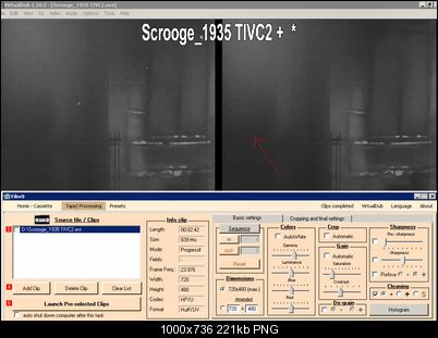

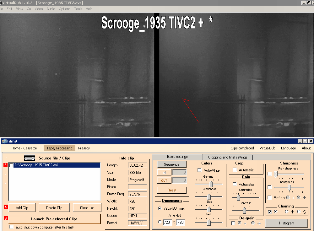

  19. RE Gilles,
    I`m still having issues with banding , The dust/spot removal modes are excellent but i get this horrible banding on the grain,
    I would like to just remove spots without affecting the grain too much as i want to use other noise removal methods like "Neat" after the spots are fixed,
    Here`s a example pic
    Heres a original clip of the source, (720X480 29fps)
    I applied IVTC to the video in the picture to remove the dups and use a 23,976 HuffYUV as input to Film9.
    Thanks.

    Hi Restore-chappy,
    Here is a draft version of FILM9 : https://www.dropbox.com/s/8qvv5a927lvoo41/Film9.zip?dl=0
    This version disables (or not) LEVELS. Which can cause this "banding" effect on Black/White film.
    Tell us whether this is enough.
    Thank you
  21. Originally Posted by GillesH View Post
    Hi Restore-chappy,
    Thank you
    Thank you Gilles and Roland for the new version, Its much better and has reduced the banding considerably- but not completely,
    I think the banding is a side-effect of the spot/dirt remover as the banding disapears when the "Cleaning" box is disabled
    Because i notice there is a some slight degraining applied with the spot remover?
    Please dont take my remarks badly as i appreciate what you are doing. This latest Film9 version is very useable and i notice the banding only on very bad material
    Could you explain the "Cleaning" functions `+ + S` ( I asssume the "S" is for Scratches?)
    Thanks.

    It will be difficult to delete everything because any remaining filter will, inevitably, impact the image.
    For cleaning , there are 3 modes:
    - Cleaning + : single image analysis
    - Cleaning + : there is a double analysis of the image for better quality , but it's slower.
    - Cleaning S : it is, too, another double image analysis but to treat clearer spots.
    The differences between modes are sometimes very subjective. It also depends on the quality of the movie.
