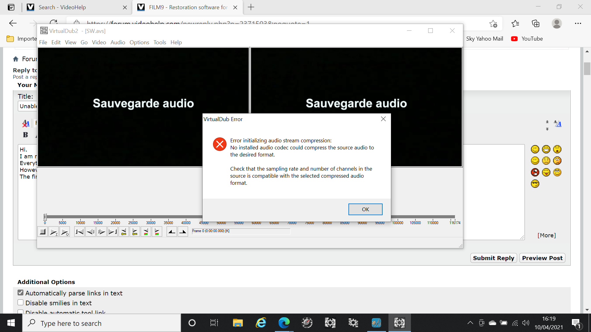

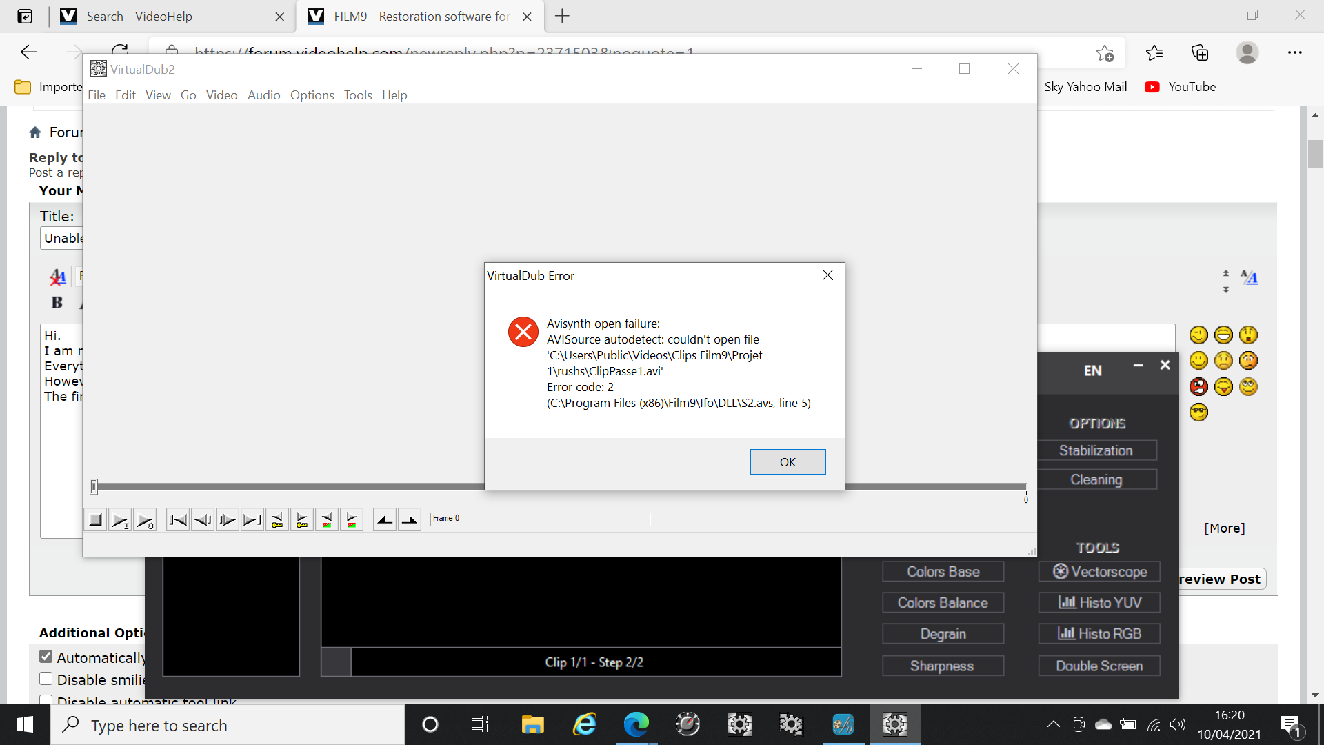

    Hi.
    I am new to Film9 and am trying to process a mp4 video file to remove film dirt etc.
    Everything looks fine in the preview windows, and the dirt is removed, and the adjusted picture looks exactly how I want it.
    However, when I start the rendering, I get 2 error messages.
    The first is that there is no codec to compress the audio and the second is that Avisynth cannot find the .avi file it needs.
    I have attached screenshots of the two errors.

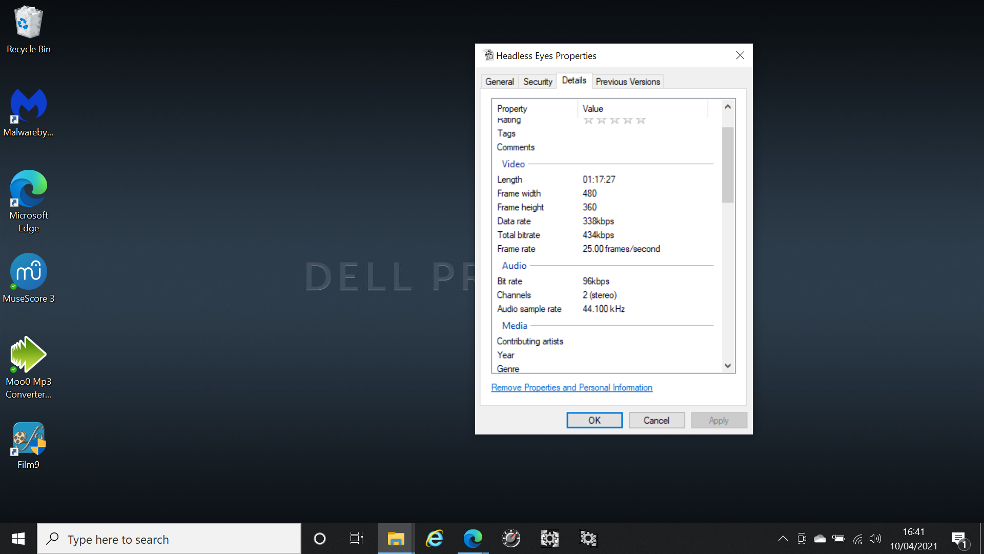

    I have also added a screenshot of the mp4 file properties.
    Whilst I am not worried about the audio issue which I can resolve in other ways, the video error obviously won't allow me to render the file.
    I have tried converting the mp4 file to an AVI one and then using that as the file I insert into Film9 to be rendered, but that doesn't help either.
    Any ideas what I am doing wrong?

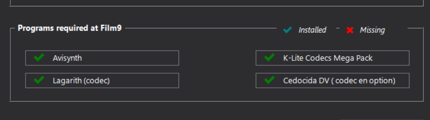

    Are you using the K Lite Mega codec pack, and not the regular K Lite codec pack?
    I noticed today an update for the mega codec pack, I can't say that would cause the issue, just a heads up.
    [Attachment 58353 - Click to enlarge]
    [Attachment 58354 - Click to enlarge]
    Apr 2021
    Hi super8rescue, and thanks for your reply.
    I have the latest K-Lite Megapack installed.

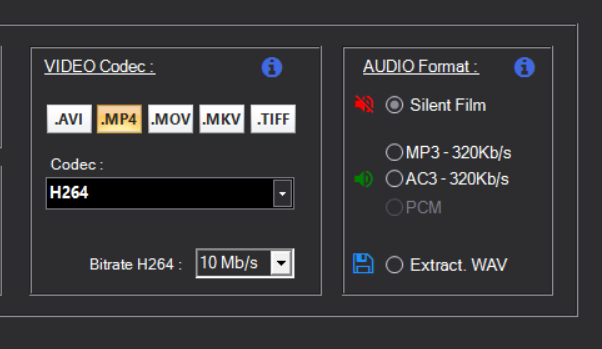

    I have tried using the H264 codec and rendering to create an mp4 file as per the source, as well as converting the file to avi and then trying to render to avi.
    Both times the same errors appear.
    I even tried selecting silent film to avoid processing any audio and still the audio and video errors appear?
    Really have no idea why this is failing to render for me.

    As a test, I selected the no audio option in the file menu, and I selected the "synchro" option in Film9 profile with 16.6 as the fps, since I have seen other posts that mentioned issues in rendering.
    This did render, but produced a file that does correct the film dirt problem, but runs like slow motion.
    Since the original file is from video at 25fps I guess this makes sense, so I am now running a silent render using the synchro option set at 25fps to see what happens.
    Hopefully, this will create the rendered file correctly at the correct speed and with the film dirt removed. At least I am not yet seeing the same errors as before, but it is odd that the file won't render using the videotape option with audio, when that is what the original mp4 file is from.

    Completely uninstall K-Lite (clean the computer if possible) and reinstall K-Lite MegaPack again directly from Film9's "Preferences" window.
    Then reinstall Lagarith (only after K-Lite).

    I think the best thing to do is for me to edit a small clip from the file I want to clean, and upload it so you clever guys can analyse it and tell me how it has been captured and converted.
    The file is 25fps mp4, and looking at it frame by frame, it looks to me like there is a random pattern of duplicated frames, where sometimes you get 3 frames that advance in sequence, and then a frame that holds twice, and then perhaps 4 frames advance in sequence followed by 1 that is shown twice, then 3 advance in sequence followed by 1 that is held 3 times etc.
    No wonder this file won't perform cleaning filters in Film9 correctly. It removes the single frame instances of dirt beautifully, but of course leaves the frames where dirt shows for 2 or sometimes even 3 frames.
    I imagine this file has had multiple processing, so that the original 24fps film has seen a conversion to NTSC 29.97fps, followed by another conversion to adjust to PAL 25fps, so the duplications are now very random, and I haven't got the faintest idea of how to get it back to a single frame per image file again.
    My attempts at using IVTC filter in VirtualDub2 are not working out as yet, probably because I don't really know what I am doing, and I am getting rendered files that are either speeded up, slowed down, or look jerky, or only seem to process a third of the film and then stop.
    I can't get my mind round how a file that is 131,261 frames in size and runs for 1 hour and 27 minutes 31 seconds, can be converted to 105,020 frames and still run the same time?
    I am presuming the fps will have to be lowered to achieve this, but at least the resulting file will hopefully allow Film9 to see single frames only, clean all the dirt, and I can then produce a new file at 25fps to make sure I can audio synch everything back again?
