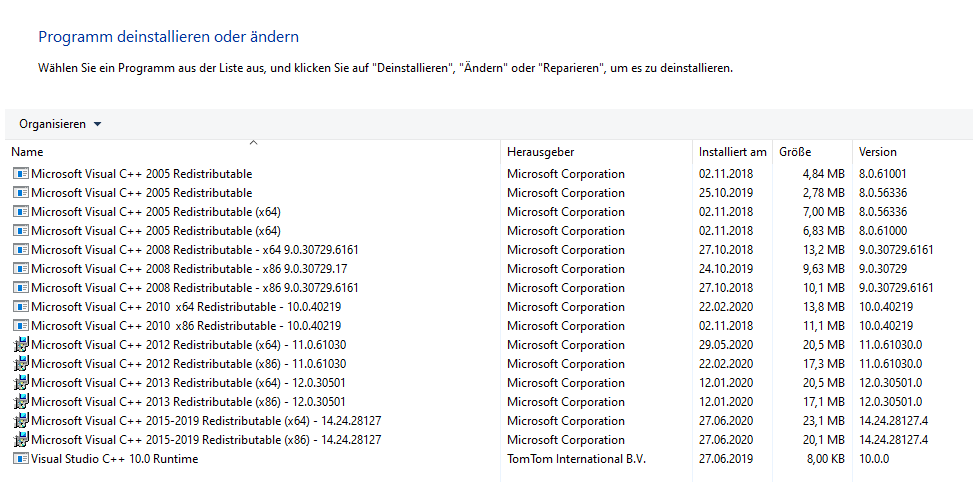

  13. Hello @Gelinox, thank you so much for your awesome software. I am currently restoring Super-8 videos with it. I will donate some money once I am done.
    I have a problem and some feedback:
    * Problem: On EVERY start of Film9, the software tells me to install AviSynth, which is installed already. On every start I do install it - next start it says again that AviSynth is not installed. It doesn't really seem to have an effect since I think everything works fine - but still this is awkward. Do you have an idea?
    * Feedback: I would have expected a message telling me that all my presets would be deleted by version 3.1. I saw it now on the forums here, but I'd expect it with the installer. Sad to have my finely adjusted presets deleted. (Where are they being saved? I might be able to grab some from a backup)
    Thanks again!
  14. Hi Ascender,
    I don't think installing Avisynth is the cause of your problem. But no more missing DLL.
    Could you give me a screenshot of the "Microsoft Visual ++ ...." packs present on your computer. You will find this list on
    "Application and Features" (I don't know the exact name in English. This is the list that allows you to uninstall an application.
    For the second point, I can only be sorry that you lost these settings. We have mentioned on this site that this update will erase saved presets. But we also mentioned it at the beginning of the "general conditions" in the installer.
    This installer does not give us complete satisfaction and we did not have the means to display a message otherwise which would have been more readable.
    Unfortunately, no way to recover this lost info.
  15. Originally Posted by Gelinox View Post
    Hi Ascender,
    Here's the list, in German though:
    [Attachment 54262 - Click to enlarge]
    No worries, don't be sorry. You're providing such a great tool. Unfortunately I found out about this forum AFTER upgrading.
    But still, I'd like to know where exactly the presets are being saved. Registry? Or just some folder? I could look into my file or system backups to restore the old version.
  16. Well, the Visual C ++ toolkit is really complete.
    Two points to check:
    - The file "C: \ Program Files (x86) \ AviSynth \ Uninstall.exe"
    OR is the file "C: \ Program Files (x86) \ AviSynth 2.5 \ Uninstall.exe" present on your computer?
    The following 5 DLL's must be present in the directory
    "C: \ Windows \ System32 \".
    - msvcp71.dll
    - msvcr71.dll
    - msvcr110.DLL
    - msvcp110.DLL
    - msvcp140.DLL
    Maybe this point before trying to find the data.
  17. Originally Posted by Gelinox View Post
    My AviSynth is installed in D:\Program Files (x86)\AviSynth, and there is an Uninstall.exe file. I do not have a folder Avisynth 2.5.
    - msvcp71.dll
    - msvcr71.dll
    - msvcr110.DLL
    - msvcp110.DLL
    - msvcp140.DLL
    I seem to be missing msvcp71.dll and msvcr71.dll from C:\Windows\system32. Where to get those?
  18. I am trying to pass a file with DLL's through this forum.
    Just copy the missing Dlls to the "C or D: \ Windows \ System32 \ "
    For your lost presets, contact me by MP.
  19. Unfortunately, copying the missing DLLs has not helped. I still get the error message about missing AviSynth installation. (Note I have not overwritten the existing DLLs, only copied the missing ones instead)
  20. If the above conditions are met, there is no reason why it should not work.
    - Your system disk on which Windows is installed is D: ?
    - How did you install Avysinth?
  21. Originally Posted by Gelinox View Post
    • Windows is installed on drive C:
    • Film9 is installed on drive D:
    • AviSynth is installed on drive D:
    AviSynth has been installed several times in several different variations:
    • via the button in Film9
    • via direct download
    • default installation
    • full installation
  22. Ok ... your system is on C and not on D.
    Uninstall Avisynth and Open Film9.
    Install Avisynth from the "Preferences" window and do not change the default options on Avisynth.
    In the end Avisynth must be installed on the system disk (C) in the Program (x86) directory.
  23. Wow. That was it. Thanks a lot for the help!
