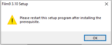

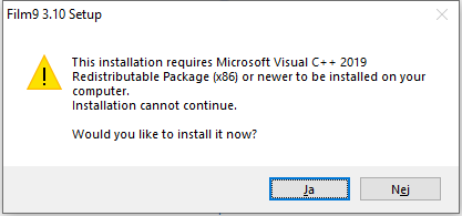

    Here is the first message.
    [Attachment 54225 - Click to enlarge]
    If "Yes" comes next message
    [Attachment 54226 - Click to enlarge]
    which takes me to the Microsoft page. If I try to install Film9 the same happens again. The C++ is installed OK.
    Kurt
  27. Here we are talking about the Film9 installer and not the Film9 software.
    At this stage Film9 is not yet installed.
    When you click "Yes" after the first window, the "Microsoft Visual C ++ X86" package is not yet installed.
    You have to click on the link "vc_redist.x86.exe" on the Microsoft web page.
    And once the package is installed, you need to restart the SetupFilm.exe
  28. Member
    Aug 2017
    Sverige
    Yes I know, but even when the MS C++ is installed I get the same message next time I run the installer.
    Kurt
  29. Have you tried installing X86 AND X64 version ?
  30. Member
    Aug 2017
    Sverige
    I have now tried to install X86 AND X64 and now at last the software installs and it seems to work.
    I have no idea if this installation with two different C++ versions affects any other programs in my computer...??
    Kurt
