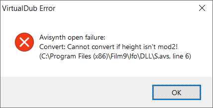

    Gettijng in touch with this software I attempted to add a film digitized to JPG with a frame by frame scanner.
    Well, JPGs are 1804x885, 200dpi.
    I'm returned this error:
    [Attachment 52358 - Click to enlarge]
    Not sure what does this mean.
    Maybe the problem is that height (885) is odd?
    Regards
    Dec 2018
    Deutschland
    You can't divide 885 by 2. Cut one pixel from the height and it will work

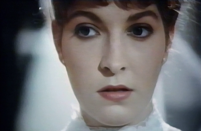

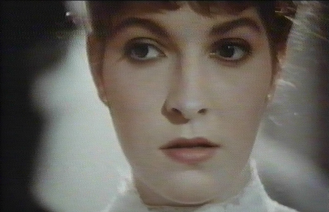

    Film9's filters are quite remarkable!
Name:	Before Film9.png
Name:	After Film9.png

  24. Originally Posted by manono View Post
    Better might be for fabiosan to post 10 seconds of the DVD or MP4 or whatever it is, from a section with steady movement.
    I agree, especially because the side-by-side video he posted looks absolutely awful (really bad encoding artifacts) and there is no way to know how much of that happened when preparing for upload, and how much is "baked in" to the video he received from the transfer house.

    First of all, I hope the transfer equipment they used was "frame accurate," meaning that, immediately after the transfer was finished, but before they added the pulldown, there should have been exactly one frame of film on each frame of video, with no blends of adjacent frames, and no flickering from a projector shutter.
    Oh absolutely not the case, the pulled down frames are never identical just very similar, and yes some are blended, some show half a frame as it moves out. From what I can tell they just pointed a HandyCam at a wall where they projected the movie with a crank projector
    At least that is the word on the street.
    Thanks guys for wanting to chase this, I really got what I needed with mpdecimate but if you really want to, here is short clip:
