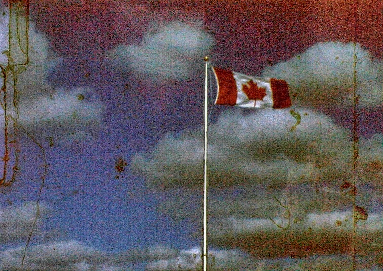

  1. I wanted to thank you again for the support on my first undertaking of old film restauration. Especially the Film9-developers hint about the doubles in the video I got from the scan service was crucial but also all the code contributions of the pros that developed the parts of this software. As I am new to this I had no clue where to start. Meanwhile thanks to Film9 I have completed the two videos - I am quite satisfied with the results.
    I started here:
    https://streamable.com/vwapd
    and ended up here:
    https://www.youtube.com/watch?v=OulrI4yaz64
    https://www.youtube.com/watch?v=0_xbdR4qEnM
    (Workflow laid out in description)
    Film9 did a great job. I will carry the experience gained over to awaiting restoration projects. If there was a wishlist for Film9 I would write on it:
    More granular color control seperately on darks, midtones, highlight, r,g,b perhaps via gradation curves - in my case I had to to color correction with Color Mill in VD2 to achieve this
    If changing videos to edit in Film9 the VD2 window will jump to the foreground and covering the Film9 Window which has to be reselected to actually complete the desired task (this is minor and only usability)
    (Upscaling with superresolution - not quite sure if this is even really useful or feasable though)

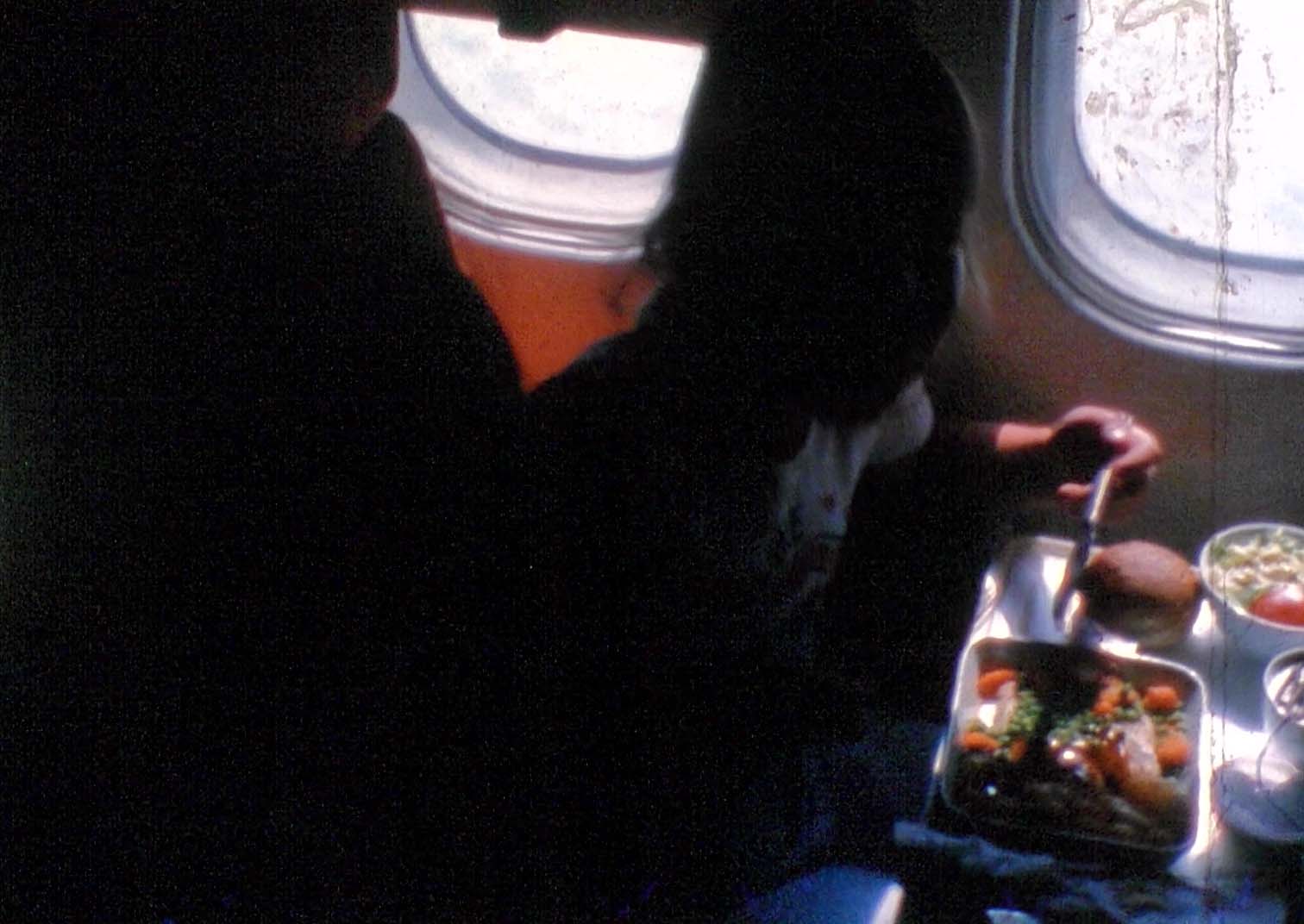

    I too was quite aware of the lack of midtone correction. You have almost no shadow details in any scene, except near the end when the original exposure briefly increases and you can actually see the sides of the cabins.
    I do my gamma corrections in Vegas, using a histogram curve. There are also AVISynth tools for this.
    The color corrections were very nice. If you are doing those manually in Colormill, you definitely have the talent. The dirt removal was very good, and the grain reduction was absolutely spot on.
    The only other criticism is that the initial scans blew out the highlights. I've seen far worse, but a good transfer house should never allow this to happen. I do my own transfers and I always expose for the highlights, and then take care of the dark shadows in post. I use a video camera for capture, but the really high-end equipment (Cintel or Spirit) has a scanner that can capture the full range, so you don't have to do too much of this. Having said that, I had some client film rescanned by a Hollywood transfer outfit because it was going to be used by the Smithsonian channel. I had them send the transfers to me prior to sending to the production company and I had a chance to compare my results with theirs. They, of course, did a beautiful job on the highlights, but even with their equipment, I would have chosen to brighten the low end of the midtones.

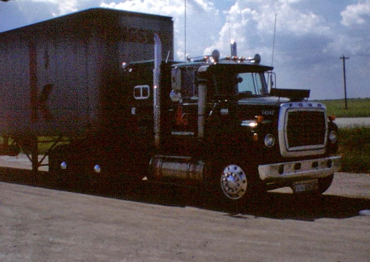

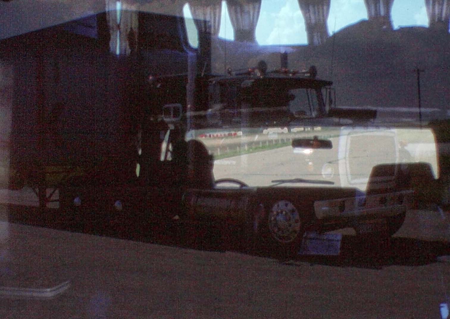

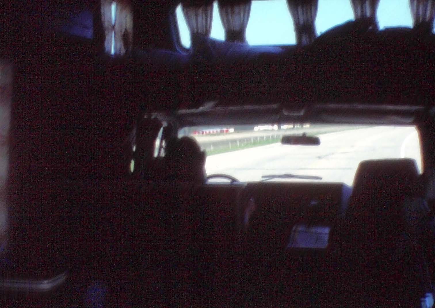

  9. Thanks for sharing those insights. To me it seems that either my source material is too taxing or that there is no scene change detection implemented /working.
    Scene 1
    Before Scenechange
    [Attachment 49130 - Click to enlarge]
    Interpolated 1/2 (Smooth)
    [Attachment 49131 - Click to enlarge]
    Interpolated 2/2 (Smooth)
    [Attachment 49132 - Click to enlarge]
    After Scenechange
    [Attachment 49133 - Click to enlarge]
    Scene 2
    Before Scenechange
    [Attachment 49134 - Click to enlarge]
    Interpolated (Smooth)
    [Attachment 49135 - Click to enlarge]
    After Scenechange
    [Attachment 49136 - Click to enlarge]
    This introduces issues with Autowhite (which is confused for some frames) resulting in bright flashing especially if the scene change is with high contrast and motion compensation (at least if "outsourced") which results in confusing sudden movement for some frames. All those frames have to be cut out at EVERY scene change (I checked my whole 1h film) which attributes to 3 minutes of playtime over all in my case and a lot of work.
    But at the same time the scenes itself have a very fluid interpolation which looks great and I couldnt spot so many artifacts so I wouldn't want to turn interpolation off or simply duplicate frames. Either it is just me or something is amiss with the interpolation at least concerning scene detection.
    As the examples of interpolation found on above linked site do not show any problem in scene changes I think it should be possible to somehow circumvent the issues I demonstrated. Most of the old movies contain a whole lot of scene changes. Cutting them all out is sometimes sacrifing critical content and always using up a lot of time. Sometimes you might want to cut out the scenes anyway (like in example 1 because of the dirt where the tapes are glued together). But most often scene changes are clean - Camera on/ camera off, no tape change) and normally wouldn't have to be cut. Cutting prior to processing with Film9 would avoid the problem but is cumbersome if there are many scenes. In my case well over 100 scenes - often quite short...
