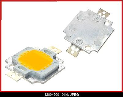

    Thanks Fred. I have practically memorized your 2 tutorial videos, watched them many times. I will add more pieces and use more naphtha.
    I also searched high and low for the older free version of C2D but couldn't find it anywhere, it really looks like it would have been the perfect solution for me and eliminated a lot of struggle with AVT software.
    Originally Posted by videofred View Post
    Very well done! What light source do you use?
    Thank you, I appreciate the compliments from someone with so much more experience than me. The LED is a 10W COB (chip on board) daylight balanced LED module. It is 10 volt DC at 1A and produces an amazing amount of light. I set the white balance in the capture software with no film in the machine so that is started off 255, 255, 255 and then locked it there. Any incorrect WB from the original film will have to be corrected in post.
    This is the LED, it's about 2x2 cm.
