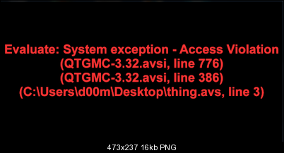

    HLEP! I NEED AN ADULT!
    DirectShowSource("G:\AVCHD\BDMV\STREAM\00001.MTS")
    AssumeTFF()
    QTGMC(preset="very slow")
Name:	QTGMC error.png
    No, in all seriousness, how do I fix this?
    I installed everything the way everyone says it is supposed to
    be installed in just about every thread on the subject.
    I am using AviSynth 2.6.0

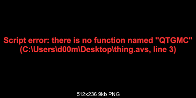

    I got the avsi file and...not much better. We're still not getting any video.

  3. Anonymous
    Guest
    For starters, run this tool.
    1. File -> Save info
    2. Tools -> Plugin Info -> Save plugin info report
    3. Post both logs and any error messages you might get.

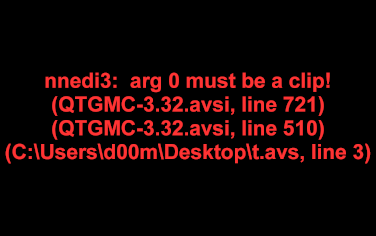

    Still won't work, but something changed so I guess that's progress.

  7. Anonymous
    Guest
    You might be missing the FFTW3.DLL support library, see here.

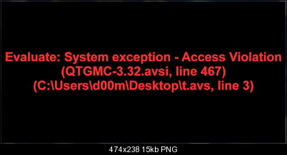

    DirectShowSource("C:\Users\d00m\Desktop\00001.MTS")
    AssumeTFF()

    I got the DLLs and it's still giving me line 467.

    1. Use this nnedi3.dll
    2. Try another preset (slow)
  11. Member bakonfreek's Avatar
    Aug 2012
    A Corn Field In Iowa
    Slow didn't work until I put the DLL in place. Now it works, finally. Thanks for that.
