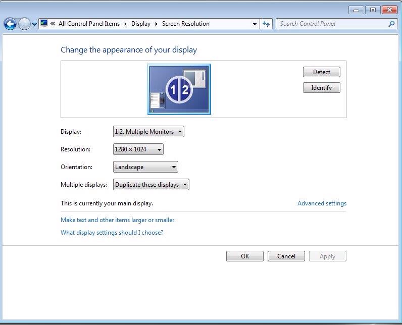

    Ok I ran into an issue I can't figure out. He had his computer monitor and his HDTV mirrored on his old computer so I figured this would be a snap on his new one. His HDTV is connected via an DVI (PC) to HDMI (TV) cable and that connection works fine. The 8700 came with a NVIDIA GeForce GT 720 1GB DDR3.
    When I change the setting on my computer display setting I can't seem to get the HDTV to mirror the computer monitor. If I change multiple display setting to Extend or Duplicate it will briefly display on the TV and then revert back to the computer monitor after saying invalid format.
    Now this same setup worked with his 6 year old Dell and a cheap video card so this has got me stumped. If I disconnect the computer monitor it will display on his TV with no issues. What do you make if this?
    Could not using a regular HDMI cable instead of DVI to HDMI to connect the HDTV somehow be causing the issue even though it worked fine with his old computer?
