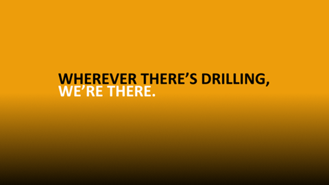

    I am using Vegas Pro 12 and am trying to recreate the outro in this video.
    So far, I have done this. What I am struggling with is being able to add that animated black gradient to the bottom of the yellow solid colour as it gradually fills the screen? Would anyone know how to do this?
    Also, I used Protype Titler to make the text. Is there a way to make the word “drilling” flip to “mining” once the yellow fills the screen?
    Thanks a lot!
    Jamie
  2. It's just a crossfade. The original has a gradient on the orange background to begin with. The gradient transition is accentuated because of the poor compression by youtube - it's probably an unintended effect

    With that in mind, how do I achieve that same effect on my video? I am still pretty rudimentary in my knowledge of Vegas! Do I just make a 1920x1080 pixel yellow background in Photoshop with gradient at the bottom, then import that image into Vegas and use pan/crop similar to what I did for the generated media?
    Apologies for not being clearer regarding the words. Basically, I just want "drilling" to change to "mining" when the yellow fills the screen. The intention is for the phrase to initially be specific to whatever equipment the video relates to (i.e. drilling), then, to always change to the more general industry phrase (mining).
    Wherever there's drilling, we're there
    Wherever there's mining, we're there
    I would just like a solution on how I can transition/swap the word drilling to mining, without any of the other text being affected in any way. Hope that makes better sense!

    Likewise you can create the shadow grade in Photoshop as a transparency, grade only -- no yellow, and add that above the animated yellow and fade it in as needed.
  5. You shouldn't need a trip to photoshop or image editor. Vegas has a media generator color gradient. So it' s just a simple transition from the prepared gradient screen, to the catepillar black background screen

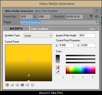

    Thanks guys. So I just used a gradient instead of solid color and used pan/crop in the same way. Here is the test video of the color expanding.
    I guess it's better, but the start of the gradient is pretty obvious/harsh and it has very visible horizontal lines, which do not look good. It certainly doesn't compare to the actual Cat video. Is this the technique you are referring to PDR? Maybe my gradient settings are just poor? Have included an image of them below.

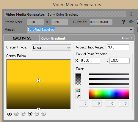

Name:	gradient settings.png

    Thanks. It's just the gradient looks really bad in that video. Starts off really harshly. Would you (or anyone?) have any settings for the gradient media generator where the gradient better resembles what has been achieved in this video?
    And then I'm done! Thanks.
  14. Are you referring to the actual gradient itself ? Yours is brighter . The original has fewer "shades" to "traverse" so will produce smoother gradient. You would either need a darker bright , or lighter dark to narrow the gradient
    Why don't you use the original colors and shades? It will look exactly the same then . Use the color picker
    Working in 32bit can help smooth out gradients slightly as well, as the intermediate blending calculations have higher precision. Dithering and adding fine noise can smooth out gradients too. But youtube compression won't hold the dither very well, if that's your target
