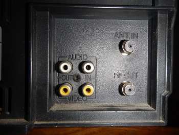

    Here's my VCR connection and my TV card connections
    I only have 2 out put connections I can use on the VCR. RF out & audio/Video but NO audio/video in on PC TV card
    So if I find this IR receiver I still need a set topbox in another room with a really long cable to reach my PC maybe? But I don't want to start messing with the The setups on the other TV's

    Originally Posted by Krazedav View Post
    Thanks for the video link. I don't have set top box in my office I can use with my PC so I can't use the IR blaster on the remote sensor as in the video.
    You don't actually need s set top box if all you want to do is record from the VCR. You could set up WMC for any set top box and say the IR blaster worked even if you have no way to tell that it did. However you really do need the IR receiver-IR blaster and remote to complete the set up procedure and record, even if it technically it serves no other purpose. I have actually used WMC to capture from something other than a cable box with this kind of set up.
    Use composite and the white stereo audio port to connect the VCR and the TV card in your PC. It is the best connection available on both devices.
    Use composite and stereo audio to connect the VCR and the TV card in your PC. It is the best connection available on both devices.
    In the video it shows attaching blaster to front of set top . No set Top so do I just plug it into the PC with out attaching to a set top like in video?
    Yes. You plug the blaster cable into the port on the back of the IR receiver and don't attach the emitter to anything. WMC can't detect whether or not the emitter is attached to a set top box.
    and which is composite?
    I see the Stereo audio RED/white.
    the 3 coaxial connection are labeled FM CATV ATSC
    and then the S-VID I
    I have to re think this. What I though was composite video on the capture card is not. I only saw it was something else after enlarging the picture
    [Edit]You need to use the VCR's RF out and the TV card's CATV connection by itself and select whatever channel the VCR uses for its RF out as the connection when setting up WMC for a set top box.
