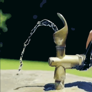

    But in the interest of experimentation, here is my results from using Avisynth + MSU_FRC. Not perfect, but not too bad....

  13. Member racer-x's Avatar
    Mar 2003
    3rd Rock from the Sun
    Number 4 is really scary.......
    you could export to image sequence and edit the frames, but what's the point?

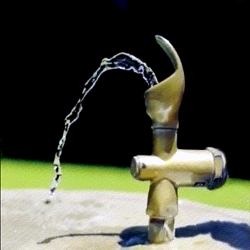

    I've discovered that by eliminating background detail, it comes out much cleaner. I guess too much detail is a bad thing for motionflow s/w....
  26. Originally Posted by racer-x View Post
    All the motion flow techniques work with blocks of pixels -- they look for blocks that move from one location to another. It the background behind a moving object is complex the blocks that fall at the edges of the object can't be motion matched. So you get distortions. Complex features or motions, or very large motions, aren't recognized and you get distortions or blending (most of the motion interpolators fall back on blending when they can't find motion).
  27. Member racer-x's Avatar
    Mar 2003
    Yes, that explains it...
    I wonder if you would get better results with a video camera. Say every 10 degrees of rotation, you extract that frame. That should make it easier to motionflow I think.

    Great job with those reference videos jagabo. They really show what happens when you use motionflow s/w on a moving object against a high detail background.
    I took the liberty to try both MSU_FRC() and SmoothFPS2() on the fountain (2 images). It seems in this case that SmoothFPS2 gives slightly better results.
