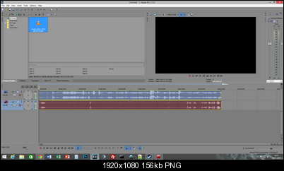

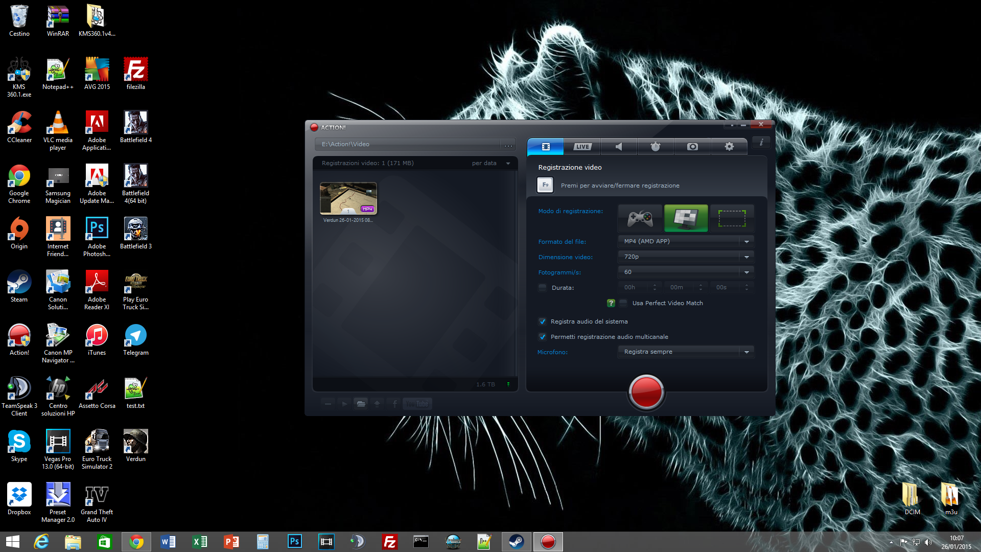

    I ecounter some problems while trying to open .mp4 video files in Sony Vegas Pro 11.
    I make gaming videos and I use Mirillis Action! to record the gameplay. You see, I am fairly new to this, I've barely recorded a couple of videos and haven't gotten around to uploading any of them, mainly because of not being able to produce them properly.
    Whenever I try to import a video I've just recorded with Action onto Sony Vegas Pro 11, it only imports the audio and there's no trace of the video whatsoever. I looked up some solutions online and they all said that I needed to install various codecs because apparently Sony Vegas didn't accept the mp4 format (Btw I ran a scan with MediaInfo on all of my recordings and it seems that all of them are AVC ). So I installed x264vfw, it still didn't work, then I installed ffdshow , no luck, xvid, divx, none of these worked. Some people said K-lite codec pack should have done the trick but I already had it installed before I even purchased Sony Vegas 11. Others, on the other hand, said K-lite was only bound to doom my computer and interfere with the codecs Vegas already had, so I uninstalled the pack and attempted again however it stil didn't work.
    The only times I could actually open a .mp4 vid onto vegas pro 11 and get both audio and video to work was when I imported an .mp4 video that I had ALREADY rendered with Camtasia studio 8 (on which I gave up because lately when I'm trying to import any .mp4 video it gives me some " cannot open file. codec missing" bullcrap).
    I'm in desperate need of help as this is preventing me from growing my channel and most importantly from engaging in a hobby of mine. Thank you in advanced for the help and for your time.

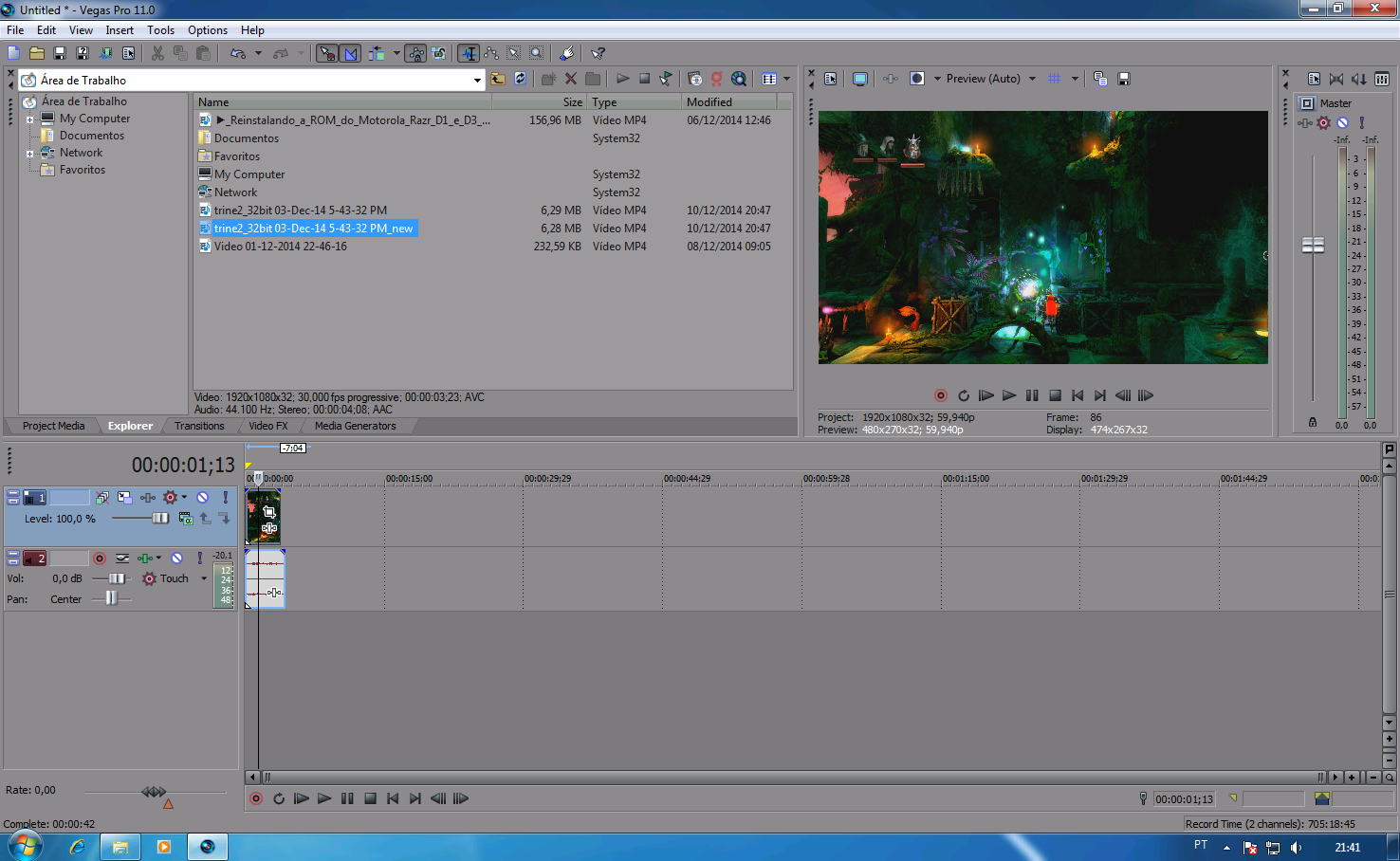

    Its very easy and very old tip.
    https://www.youtube.com/watch?v=ux9_ZoY4T_g
    Get file here: https://www.dropbox.com/s/u8htwttmqkq2g3y/qt7plug.rar?dl=0
    Works on Vegas 9, 10 and 11.

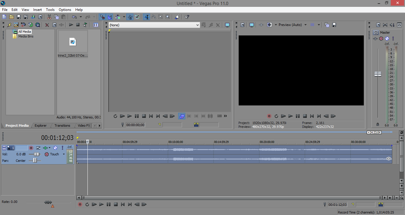

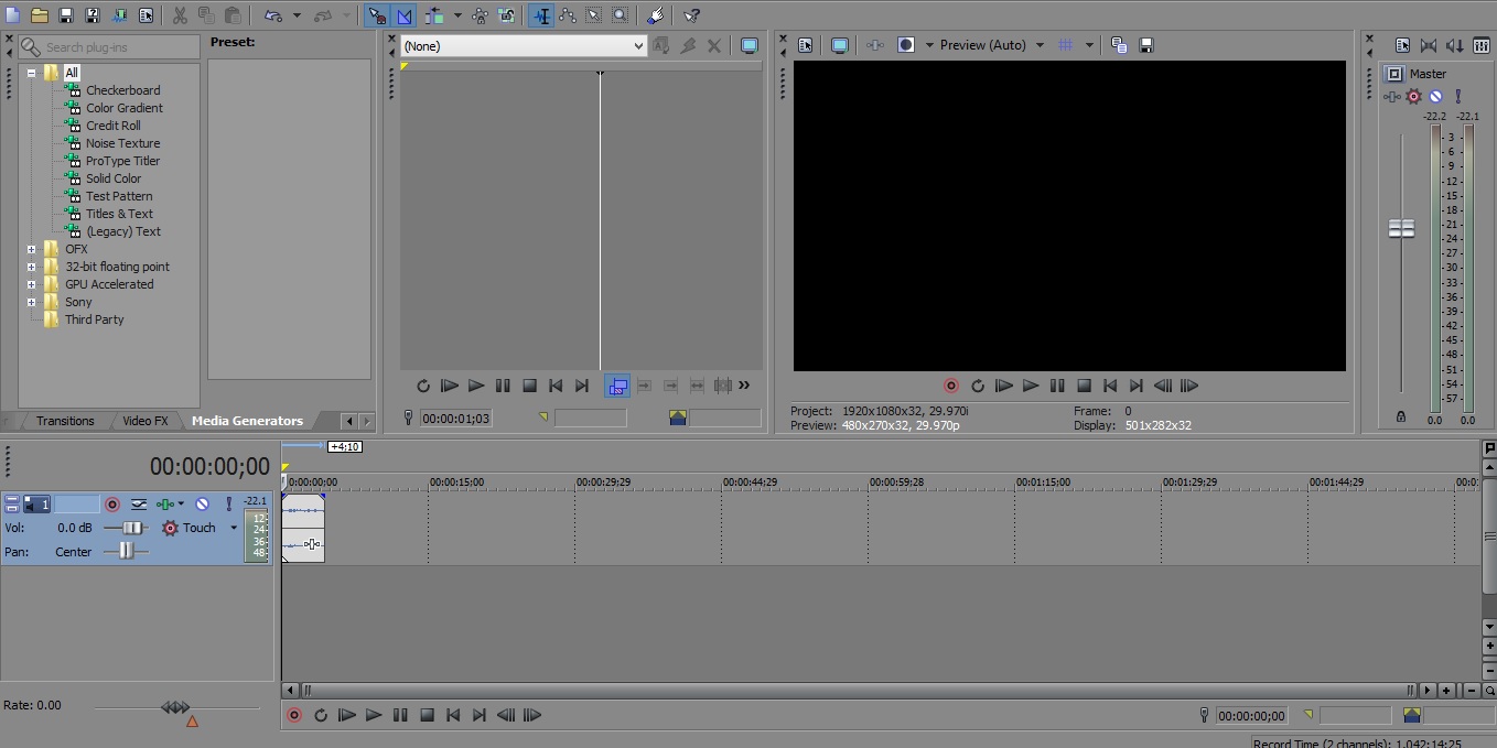

  8. You said "no trace" of video, but is there video, but black screen? Or is the video track completely absent, only audio ?
    If what Cauptain suggested doesn't work, you can probably re-wrap the MP4 as MP4 , but using the "mp42" format (base media version 2) profile instead of "mp41" and it should import . (At least it works in some versions of vegas that have the dreaded "black screen", but audio present problem). You can use ffmbc for example . But if you have "no trace" of video, not just black screen video track, then it might be a different issue

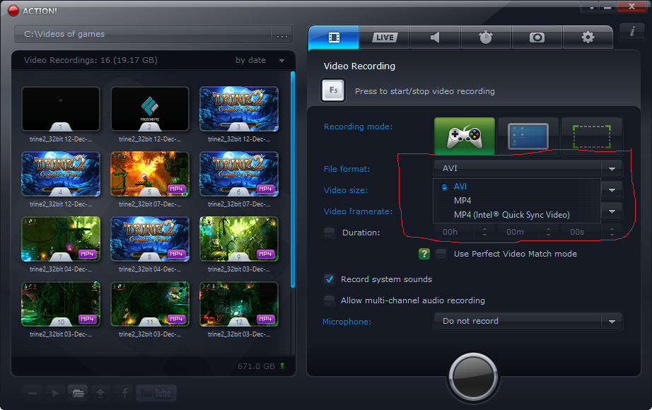

    Not familiar with your re4cording software but are you restricted to mp4 output ?
    Try to see if this re-wrapped clip imports in your version
    BTW, your audio is longer than your video in this clip
    Hi, thank you both for answering. Sadly the video is not present, as in Vegas doesn't even recognize that the .mp4 has a video track. It only imports the audio track on my timeline. I'll attach a screenshot to clarify things up.
    As for the re-wrapping of the clip I've never heard of ffmbc before and sadly my first attempt at using it has failed. When I run the ffmbc.exe a command prompt window opens and automatically closes shortly thereafter.

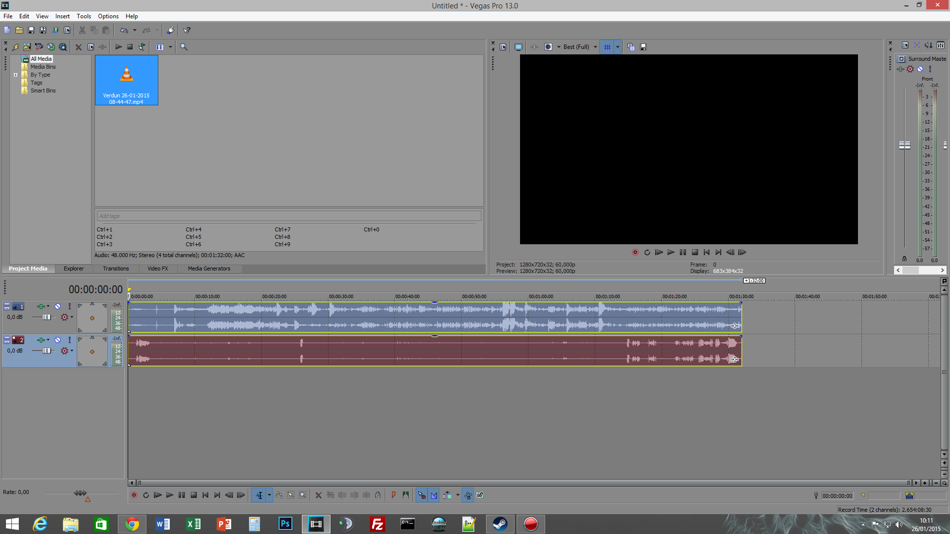

    Whilst the .mp4 does not work (same old problem : Only audio gets imported), the .mov works flawlessly.
    I do have installed quicktime, version 7.6.9 to be precise. I opted for it over the latest version because I came across some forums where people lamented problems similar to mine and apparently switching from the latest version of quicktime to 7.6.9 did the trick for them. Sadly it did not do the same for me
    I sincerely thank you a lot. Even if this not solve the problem itself, it's enough for me to get started. I seriously can't thank you enough. I'm awaiting further instructions

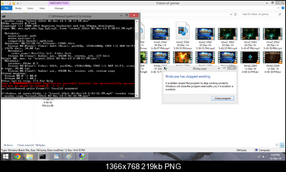

  18. Batch rewrapping to MOV with ffmbc:
    1) download ffmbc, easiest way is to put ffmbc.exe into the same folder of MP4's to be re-wrapped, so you don't have to worry about file paths
    2) copy & paste the following in notepad in the same folder of MP4's , save it, rename the extension from .txt to .bat. (e.g. from "batch.txt" to "batch.bat")
    for %%a in ("*.mp4") do ffmbc -i "%%a" -vcodec copy -acodec copy "%%~na.mov"
    pause
    3) double click the .bat file
    This will rewrap all MP4's in that directory to MOV's which will take on the same name as the input (e.g. "file1.mp4" will have a corresponding "file1.mov"). Original files will not be overwritten (The MOV's will be a "copy", just in a different container)
    If you want , you can specify paths, different directory paths for ffmbc.exe and input / output files by changing the batch file

    I can reproduce your issue and correct this using my first post. Open ANY MP4 if used qt7plug tip.

    Action does indeed have an export feature, but I have never used it as it is greyed out. So always after I finished recording, I would import into the video editing program the file Action! had automatically saved into the pre-assigned folder.
    But then, from what you're telling me, it could be that the problems I'm having importing the .mp4 files recorded with Action! come from the program itself, and that there's nothing wrong with Sony Vegas?

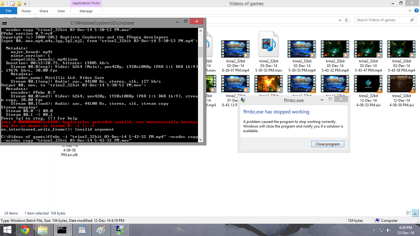

    So I did as you have told me but when I tried to run the .bat file THIS happened :
    It did rewrap some of the files, some it did not, and it gave me plenty of errors besides that one.

    GUYS! I think I might have found the problem.
    So apparently I was wrong, Mirillis Action DOES have a setting to change file format, and I think I was using the wrong one.
    [Attachment 29076 - Click to enlarge]
    Apparently I was using the MP4( Intel Quick Sync Video) and not the regular one.
    SO. I tried making an .avi recording, it worked flawlessly. Vegas had no problems importing in, the file size wasn't huge, and I'm more than happy I can now proceed with my recordings. I feel bad about losing the previous 2 hours of footage I had recorded that I can't use but oh well, our last mistake is our best teacher and practice makes it perfect right? Now I know better.
    I also tried making a regular .mp4 recording although I cannot use it for this particular gameplay since it can record only up to 720. To my surprise, using the regular .mp4 setting WORKED AS WELL. Both the audio and video tracks got imported by Sony Vegas, and I couldn't be happier as this means there's nothing wrong with my codecs.
    I ran a scan on the file with mediainfo and this is what I got; the sub-format was the same as those of the files I had recorded with the .MP4 Intel Quick Sync Video, so it still remains a mystery to me why those won't load properly into Vegas.

    But the only problem with Vegas 9, 10 and 11 is load VIDEO part, not AUDIO...
    Once again, use my trick. Its a unny solution for your problem.
    Look your file without trick on Vegas Pro 11 :
    Look your file with trick on Vegas Pro 11 :
    Is this??

    This is my problem. Just this. Vegas doesn't load the video track. There is ONLY audio.
Name:	my issue.png

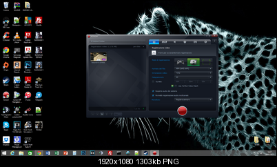

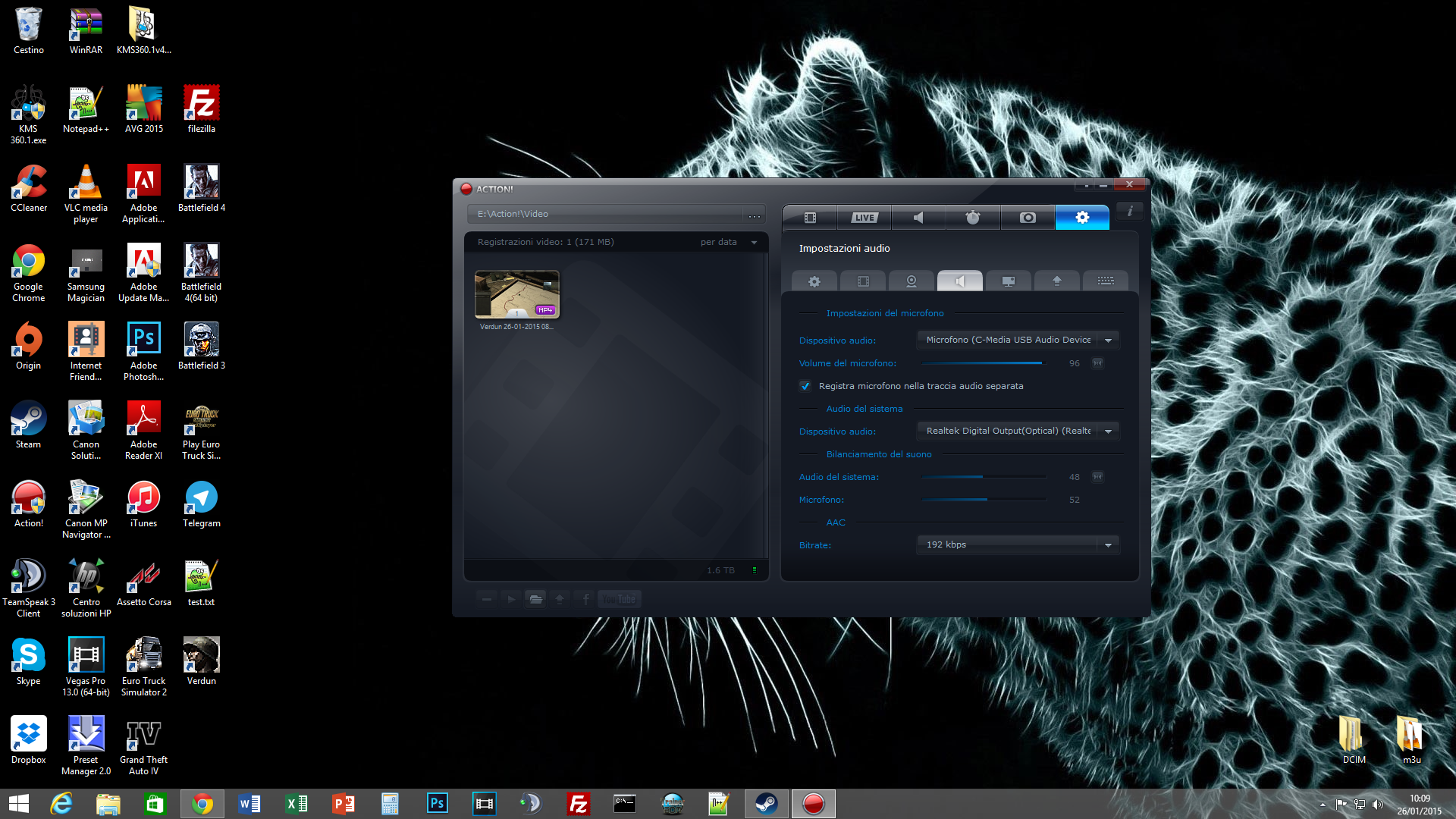

  29. hello everyone, I have the same problem user "cornery19" But the problem was born at a time when I wanted to record my gameplay using the separate audio track for the microphone.
    I state that I also use Mirillis action to record my gaming sessions,
Name:	Desktop 26-01-2015 10-07-24-131.png
ID:	29905Click image for larger version
Name:	Desktop 26-01-2015 10-09-19-886.png

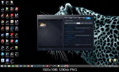

    as I said before until I held the microphone in the settings of Action in order to have a single audio track, sony vegas pro 13 mattered without problems all (so I see both the audio track that the video); but since I wanted to manage separate my voice than the audio track on the game (and because the program allowed it) I just tried to use separate tracks, and I realized that in the 'import the movie to sony vegas pro 13 shows me only the audio tracks (one of the game and the microphone) but not the video track.
Name:	Desktop 26-01-2015 10-11-21-189.png
    Anyone have any idea how I can fix? thank you
