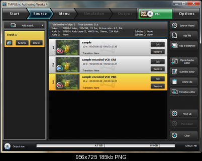

  8. The TDA don't like MPEG1 variable bitrate video

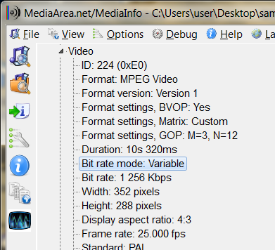

    MediaInfo of you sample:

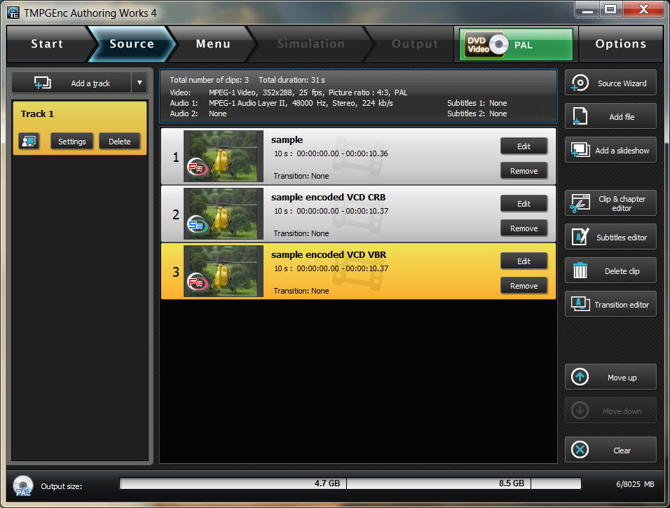

    I encoded for test mpeg1 VCD VBR and CBR bitrates
    the mpeg1 CBR marked to not re-encode:
