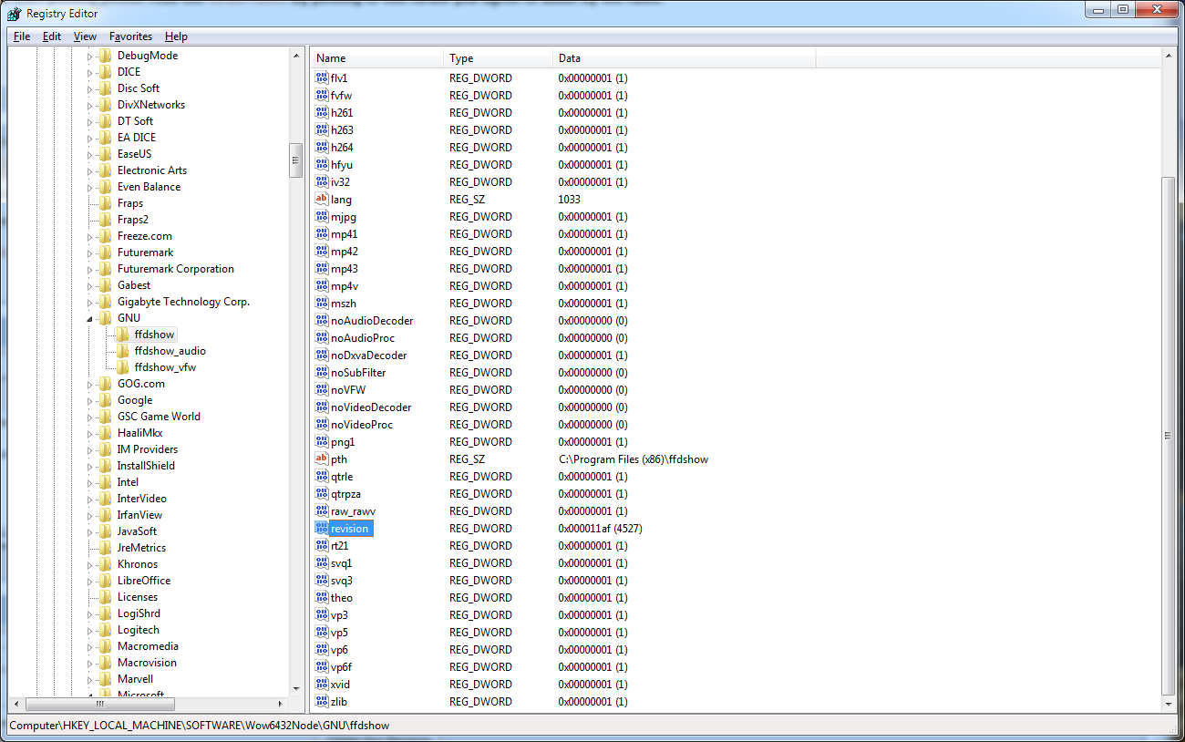

    FWIW --- this is the reply that I got (via P.M.) from Atak himself:
    1) install older version of ffdshow
    2) change revision number to some fake high value
    NOTICE: I don't use RipBot, therefore I cannot check whether the trick works or doesn't work.

    Aug 2004
    Thank you very much. That works.
