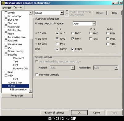

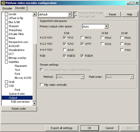

  9. You can specify an output type for ffdshow's encoder configuration. For uncompressed output, it probably defaults to RGB, but you can change it. After selecting "uncompressed" click on "generic" and you'll see the output option.
    I've never used Vegas, but you could try disabling all the output types in ffdshow's decoder configuration aside from YV12 (and maybe NV12). It's under "Output" in the ffdshow VFW configuration (and also the ffdshow DirectShow configuration). When ffdshow is decoding you should be able to hover the cursor over the ffdshow icon and the tooltip will tell you the input and output video type.
    I'm not exactly sure how it works, but I'm pretty sure programs can tell ffdshow their preference for video type and ffdshow will convert it to that format if it can. If you disable the RGB output options that may solve the problem. Changing the "primary output colour space" setting to YV12 might also fix it without needing to disable the RGB output options.

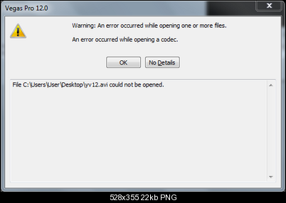

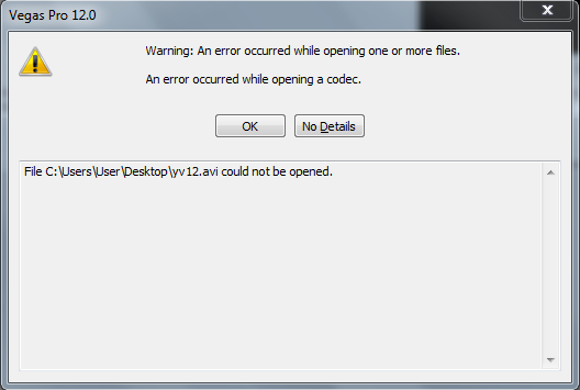

    only yv12.avi can't be opened:
    and i installed "helix yuv codec suite 1.3", didn't work.
  11. Originally Posted by hello_hello View Post
    [Attachment 29022 - Click to enlarge]
    didn't work. i want YV12 because RGB file size is insanely big.
