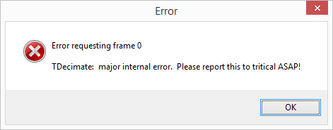

  18. Noobtastic
    Dec 2014
    Desert Country
    I am using AvsPmod 2.5.1 and it is showing python library errors and a memory access violation in Windows.
      File "avsp.pyo", line 9379, in OnMenuVideoToggle
      File "avsp.pyo", line 14234, in ShowVideoFrame
      File "avisynth.pyo", line 464, in GetFrame
    WindowsError: exception: access violation reading 0x00000067
    I have emptied out my plugins folder, added them back in as required and narrowed it down to nnedi3.dll.
    I exchanged the 'Vit mod 2011' version for the 'Vit mod 2012' version and now I am getting;
    nnedi3_rpow2: arg 0 must be a clip!
    When I add the line back in for final resize;
    nnedi3_rpow2(2, cshift="Spline64Resize", fwidth=960, fheight=720)
    There must be a broken reference somewhere?
    [Edit] If I comment out the nnedi3_rpow2 resize I get the python errors and Windows access violation error.
    I changed SetMemoryMax(600) to SetMemoryMax(2048) and received the following errors;
    Exception WindowsError: 'exception: access violation reading 0x74736C9E' in <bound method PClip.__del__ of <avisynth.PClip instance at 0x020F8468>> ignored
    WindowsError: exception: access violation reading 0x00000001
    Which version of Avisynth are you running btw?
    [Edit] Ok figured it out, nnedi3.dll was the culprit - I had to download this version and now the script works.
