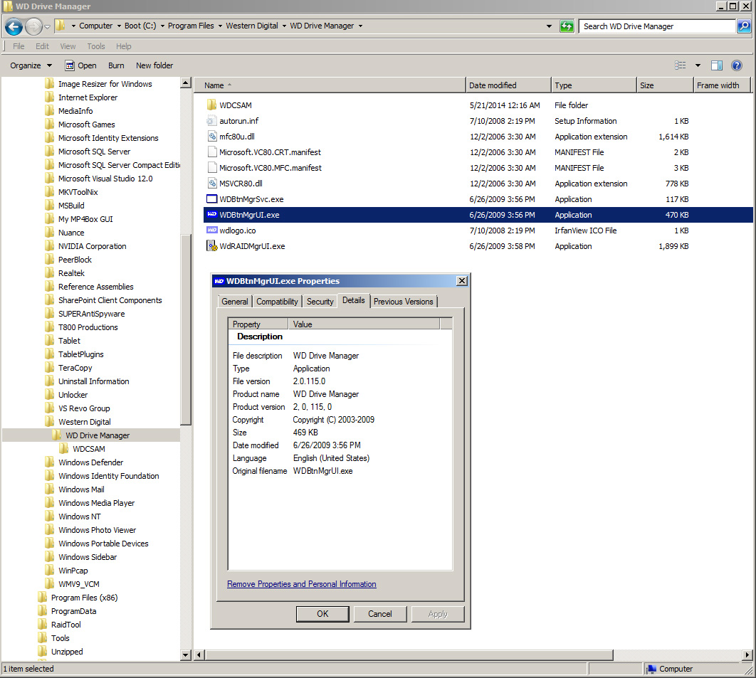

  9. WD Drive Manager software? Do you mean WD Smartware? If so, I do have WD Smartware running but the bloody drives still disconnect...
    Here is a screenshot...
Name:	WD Drive Manager-1.jpg

  16. Originally Posted by DarrellS View Post
    sorry but under C:\PROGRAM FILES \Western Digital i do no have the folder you have. Instead I have a folder named WD SmartWare
    I checked and there is NO application or exe with the name in your screen capture...
    Nov 2002
    I had to download the software from WD. It didn't come with a drive. There was no mention of it in the forums either. I just remembered having this software a few years back so I searched and searched until I found it.
    Here is the download site...
    http://support.wdc.com/product/download.asp?groupid=204&sid=89&lang=en
