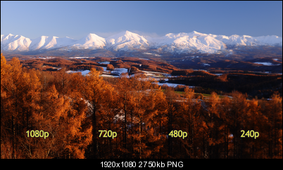

    Here's a sample you can use to figure it out for yourself. It is 4 panels Side-by-Side "tryptich"-style, at progressively smaller resolution: 1080p, 720p, 480p and 240p (wanted to make the last obvious and show how far we've gone since VCD). I'm uploading it as PNG so there shouldn't be any quality loss due to compression (except for what was on the 8K master jpg). All downsizing was bilinear to maintain smoothness but also to avoid ringing/halos (which might skew the impression of sharpness), all upsizing back to 1080p was nearest neighbor in order to demonstrate NOT the capabilities of an upscaler but rather what the equivalent pixel size difference would be. All was done in 16bit color (aka 48bit) until after all the resizing and compositing was done.
    Put that on your screen and sit where you normally sit. See where you can and can't tell the difference.
    Only downside is this doesn't show motion, which does affect the perception of detail (in both good & bad ways).
    <edit>I'll post a 4k/UHD version soon...</edit>

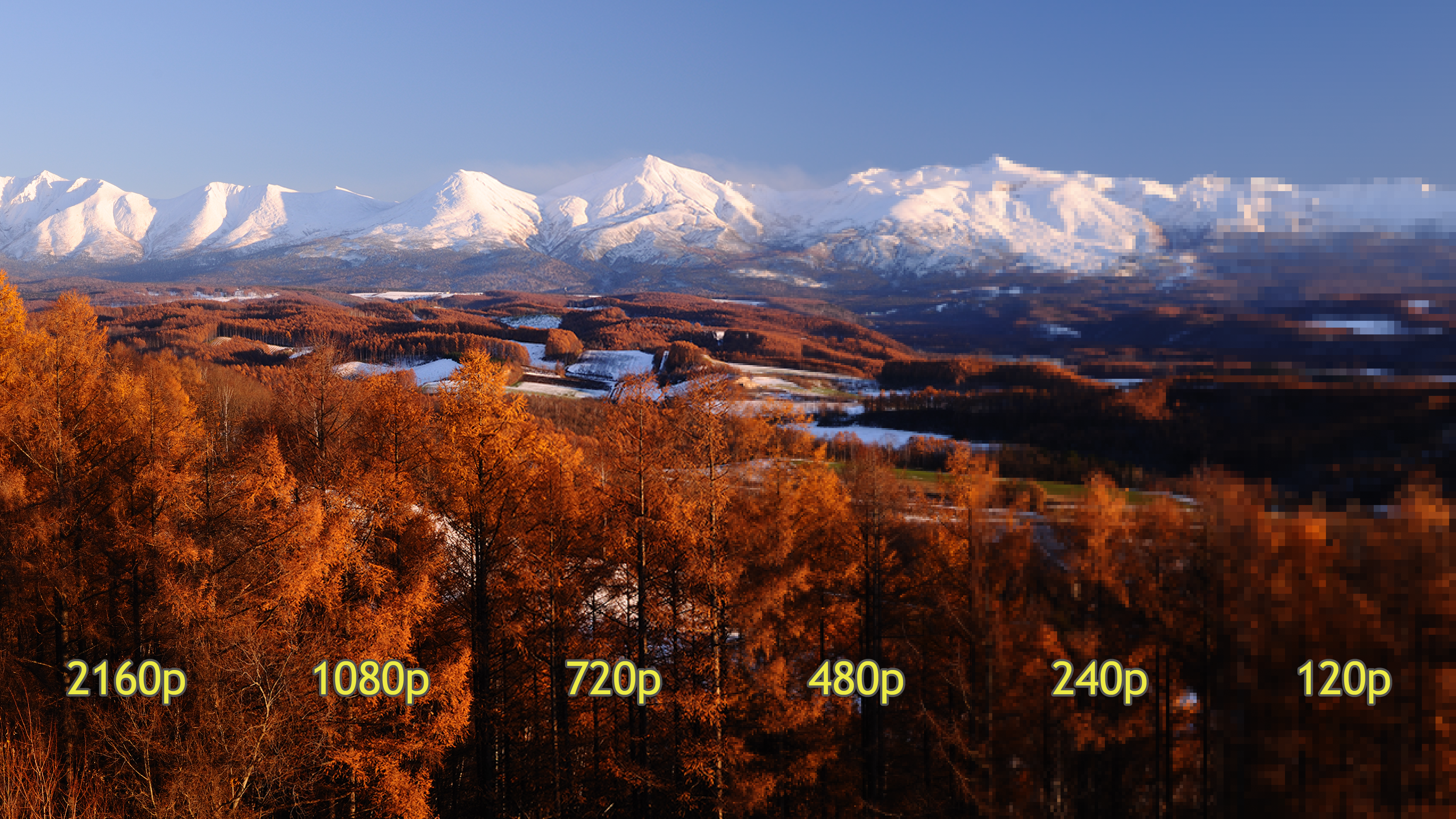

    Here's that UHD(2160)+ comparison clip I said I was going to make...
    (optimal comparison viewing only on a UHD TV)
