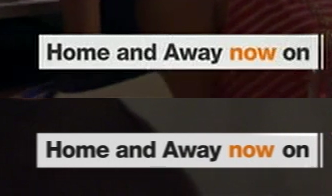

  1. I captured this broadcast tv video sample and wondering how I can get this similar quality out of my video compression, especially from graphic titles. The title at 8 seconds looks "softer" and blends in with the video. However, my titles over my video "sticks out" and looks little sharper (video is same resolution as broadcast sample, 720X576). I may being to picky but my graphics and video looks amateur and not what Im looking for. If you need examples and any more information, please let me know. Thank you. (Does this issue I'm having, have anything to do with this: http://blogs.adobe.com/aftereffects/2013/06/bicubic-resampling-for-improved... )

  4. Don't mix "compression" with "graphic design" , those are different concepts
    From a technical standpoint, the "original" is worse. There are oversharpening halos, color bleeing, more compression artifacts. (But the graphic has been through 1 more generation loss than your version).

    The other difference is subpixel interpolation . The original graphic wasn't placed on full pixel boundaries, but on 0.5. This generates a softer edge. This example shows the difference on the vertical . Vertical softness is more important for broadcast because of interlaced displays, and sharp edges can cause line twittering. Blurring the graphic can achieve a similar effect

    "From a technical standpoint, the "original" is worse"

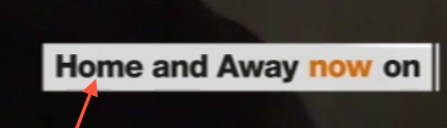

    For me personally the original looks better, and the text looks somewhat "clearer" then the mocked sample. To me, its almost as if I have scaled up this graphic if you look at the edging of the text. I know I may focusing on issues on the graphic, but the outcome on the quality of the graphic has to do with how its compressed, right?
    Thank you.

  8. Originally Posted by BroadcastTVS View Post
    Thank you posiondeathray, I have much of a better understanding now. Spot on with 'Vertical softness.'
    Thank you.

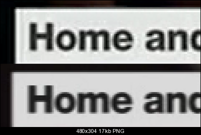

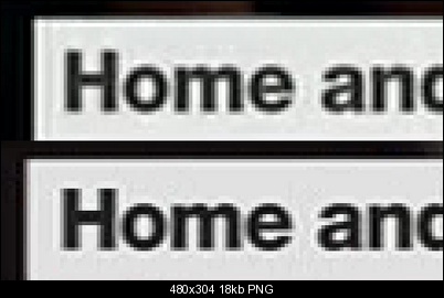

    You are contradicting yourself now. On one hand you say the original "blends" in more with the video, is softer . Now you say original is "clearer" . You can't have both

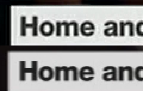

    It's more "clear" because of the halo artifacts. Those are micro contrast edge enhancements from sharpening, made worse by compression artifacts. Zoom in to picture to see them. Oversharpening halos are "unprofessional"
    1:1 crop
    4x nearest neighbor enlargement
    Certainly the viewing audience doesn't want distracting station logos and overlays. Maybe the station does.
    Choose one - either unobtrusive and soft, blending in. Or sharp , delineated edges . You can't have both
    So again, from a technical standpoint, the original is "worse"
    Yes, very much so . Lossy compression throws away bits of data each time. Think of how you save and resave a jpg image over and over again. The "original" here has been through 1 more round of compression compared to yours

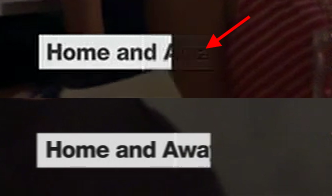

    I used After Effects. You mentioned you did the overlays/graphics in AE . Just position the graphic to 0.5 instead of integer values. e.g. if original Y position was 100, move it to 100.5, or 99.5. Or vertical blur would achieve similar effect
    I don't believe so IMO, due to the fact this was captured from a broadcast TV station and what you see in the example is what you'll see when viewing, it has to be somewhat professional?. I may be going off-topic and appreciated the help
    I'll re-iterate - on a technical level, the "original" that you presented is clearly worse because it has halos, compression artifacts, worse chroma bleeding . Those are "technical" aspects when you look at video. Do you think the original broadcast master had compression artifacts? Do you think they degraded it on purpose ? Absolutely not. Not a chance in hell. The sharpening / halos are a combination of both , post sharpening and it's enhanced by the compression artifacts
    Do you understand that this isn't really a valid comparison ? (It's not really an "apples to apples" comparison) . You're comparing different generations. So you can degrade it, you can blur it, you can oversharpen it, you can add artifacts if you want , but you should understand everything goes "downhill" . Quality starts at the source. Everything gets worse after each stage. If you degrade it at the beginning, it's only going to look worse when it's actually broadcasted, when viewer actually sees it
    Added some blur, adjusted the levels, sharpen it a bit .
