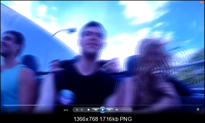

    Hi, I am quite new to video editing so I'm sure there's something simple I'm missing here if anyone can help. I've been recording on a gopro hero 3+ black edition and editing with Sony Vegas Pro 11. All video files look great straight off the camera and in the preview window while editing but when I render the video some of the clips seem to have overlapping frames which creates a kind of blurry shaddow around the moving objects. I've attached a screenshot of what I'm talking about. I have used clips of both 1080p at 30fps and 720p at 60fps so I'm wondering if that has something to do with it.
    If anyone has any advice on how I can sort this it would be greatly appreciated but like I said I'm a beginner so if you could make it easy to follow please

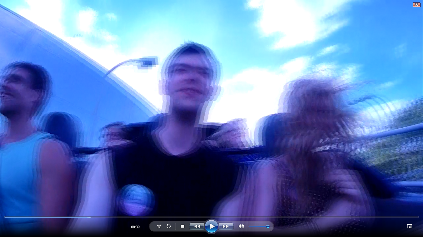

  2. You need to disable resample in vegas, and match the frame rates of the videos to the project settings. When they don't match and you have 'smart resample' enabled, it will blend frames causing "double images" that you are seeing
