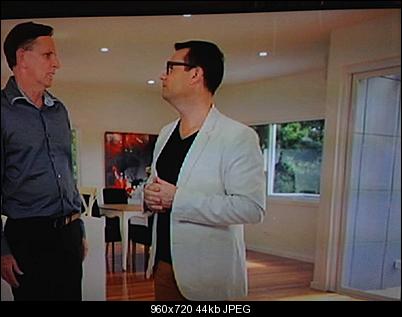

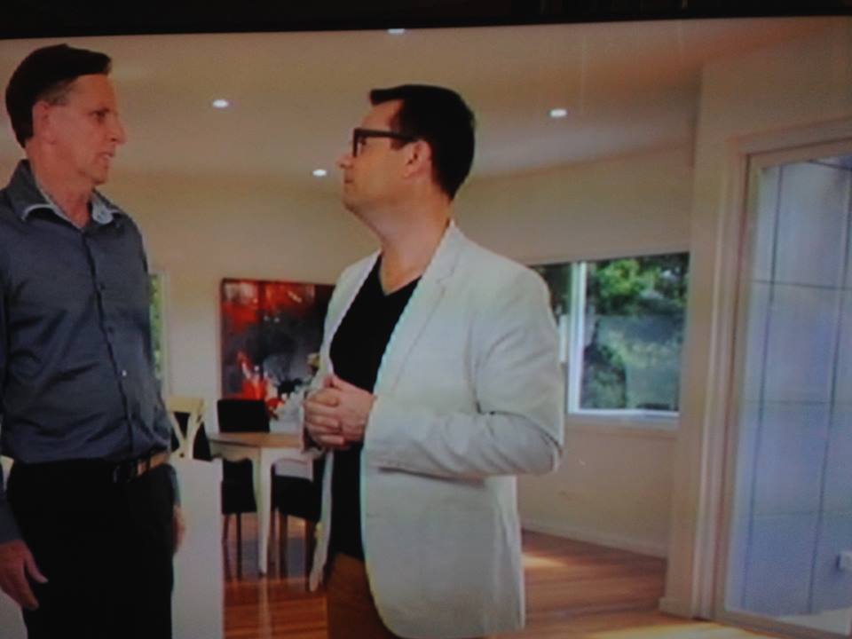

  4. Here is a rough sample:
    You can see the jagged lines which also a shown on graphic titles.

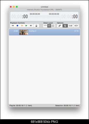

    Playout software:
  5. A sample means an untouched video sample. However, based just on the screenshot it looks as if it's been very poorly deinterlaced already. Did you do that somewhere along the line? Or the Adobe encoder? If so, you should turn off the deinterlacing in whatever caused it. Unless it's a hi-def source, you should probably cap at standard-def. If you can't get the interlaced source, your video is already ruined.
  6. Originally Posted by manono View Post
    The sample footage was 'progressive' square pixels 1280X720 originally, and has been down converted to 576i Widescreen rectangle pixels (for title overlay), could that be the issue? But if titles were made especially for a PAL output, why am I getting the same quality issue?
    EDIT: I did a test changing the output settings to 1080i (using SD and HD footage) via HDMI and results were good, only PAL seems to be the problem. Hopefully there is a solution.

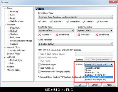

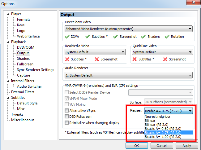

  15. I don't know Adobe tools but usually you can find a choice of resizing algorithms like Bilinear, Bucubic, Lanczos. The upscaler used by the media player can vary too. MPCHC for example:
