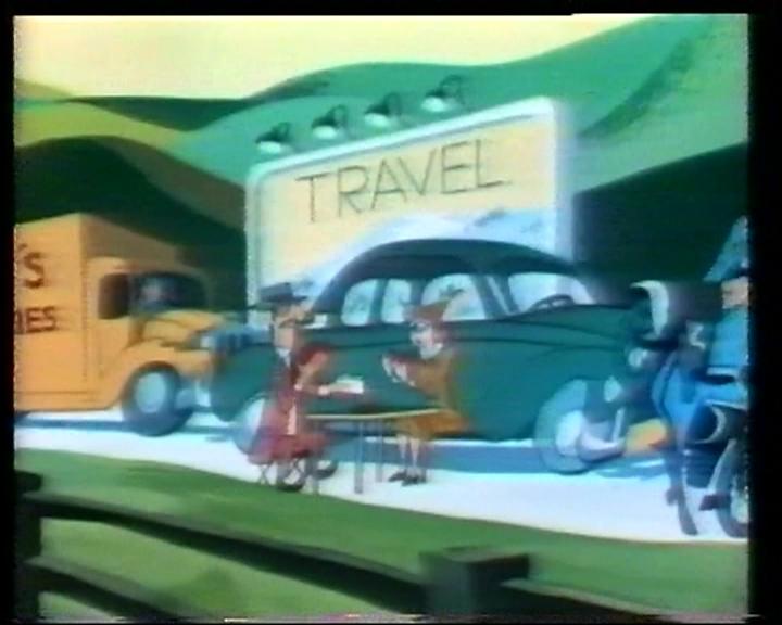

  4. I'm not seeing that problem here:
    Use VirtualDub instead of VirtualDubMod (the latter is very outdated). VirtualDub supports YV12 without the need for external codecs.
    If you still have problems, what's your entire script?
