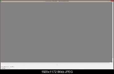

    I go on AviSynth Script Creator and when I press DirectShowSource it gives me this gray preview screen. I looked it up and some people installed K-Lite Codec Pack and it seemed to fix the problem for me but then the encoding process freezes at 99.85% and it seems like other people were having the same issue so I uninstalled it. At one point, I thought that the gray screen was just some kind of glitch so I let it encode and see what would happen. The product was that the entire video was gray besides the subtitles that were burned into the video.
    How do I fix this and what was the problem in the first place? It does this from time to time and I dont know why. Im still a complete noob in video encoding so dont be so harsh on me..

  2. It usually means you don't have the proper directshow filters installed on your computer . You can use FFMS2 instead of DirectShowSource
  3. DirectShowSource isn't reliable, or frame accurate. It should be a "last resort' method. Instead of DirectShow choose the file indexer to open the video. Add the indexing job to the queue and run it.
    What type of video (files) are you re-encoding)?
  4. I was trying to convert .mkv with .flac to an .mp4 with .aac, thats pretty much it. What do you suggest I do? I reinstalled K-Lite Codec Pack again by the way, and its working fine now and not freezing unlike before for some reason...
