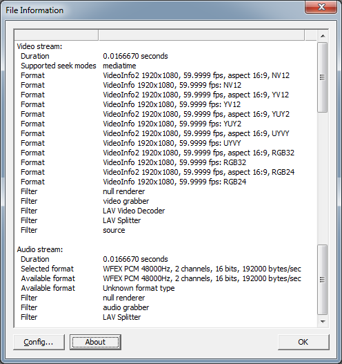

  9. Is it still 2 frames only ? That corresponds to what the screenshot says.
    I think you need to override LAV, it shouldn't be used for this. You can use win7dsfiltertweaker / codec tweak tool or similar utilities to temporarily disable LAV . Then close / restart vdub and try again
    Did the .avs script show 2 frames as well?

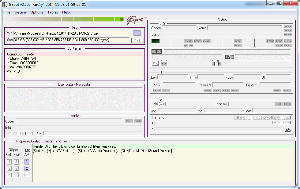

  11. Open the AVI in gspot and post the results (screenshot) , also mediainfo (view=>text) and copy & paste those
    1) Another thing you can try, is opening the AVI directly in vdub, and checkmarking the box "ask for extended options" in the open video file dialog box. This will give you more options later after you push open, then checkmark "re-derive keyframe flags"
    2) Instead of DirectShowSource() in avisynth, try AVISource()
    3) Next, try graphstudio
    a) graph => insert file source (async.) . Browse to the fraps file and select it (push ok, ok)
    b) graph => insert video renderer => video renderer
    c) Connect the pins from the output of the file source to the input of the renderer (just click and drag a line). It should automatically fill in the intermediate boxes. Post a screenshot. Notice the time in the top right corner, push play, report what happens
    Nov 2009
    NJ, United States
    And...
    Gave this a shot. Nothing changed as far as I can tell. D: Still just a 1 or 2 frame video (depending on if I did this either directly to the .avi without DirectShow, using DirectShow, or using the .avs... tried all 3)

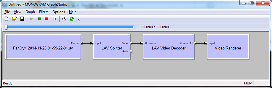

    Screenshot of the Graph:
    When I click the play button, the time says
    "00:00:00 / 00:00:00"
    But, the ActionMovie Window: Video Renderer pops up, and sure enough, the footage plays along in the renderer.
    Also, just wanted to say that I really appreciate you helping me out like this
    This file has been a huge pain, but it's not really something I can go back and simply do-over x.x so i'd hate to lose the footage.

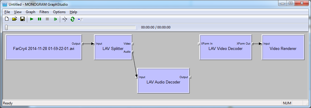

    Just to be sure, after I disconnect the LAV Splitter from the LAV Video Decoder, i'm not connecting the splitter to anything but the Audio Decoder, correct?
    Such as this?
  20. ^ yes, you can delete the lav video decoder, and video renderer boxes. This new graph needs a new name eg. "audio.grf"
    Can you also test post #18 above ?

    What happens when you disable lav, and do the graphstudio post #11 3a,3b,3c (ie. same thing but with lav disabled on your system)
    I load in the File Source, and Video Renderer from part a) and b)... but it won't let me connect them. When I drag the source Output to the Renderer Input, nothing happens and they don't connect.

    Instead of "Lav splitter" try replacing with the generic "AVI Splitter", from graph=> insert filter , save the graph, and redo the tests (without audio first)
    Not allowing this, either.
    When I try to drag the source Output to the AVI Splitter input, nothing happens. It freezes for 1 or 2 seconds, then nothing happens.
