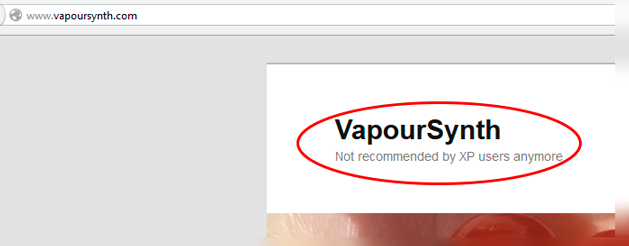

    Vaporsynth seems an interesting project!
    The message on the home page of the website cracks me up:
    http://www.vapoursynth.com/
  20. Member Cornucopia's Avatar
    Sour grapes from the VapourSynth folks - it was NEVER recommended by XP users!

  21. Originally Posted by newpball View Post
    Yeah..... it's a bit like not being able to upgrade IE on XP. The disappointment is almost too much to bear.
