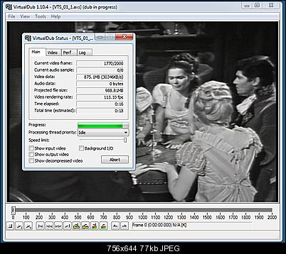

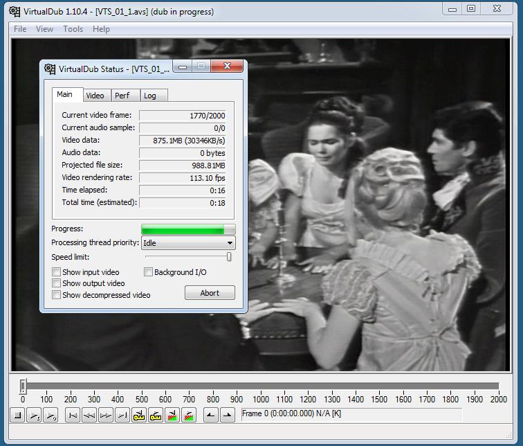

  22. Here's the ffmpeg log:
    C:\Users\John\Desktop>"G:\Program Files\ffmpeg\bin\ffmpeg.exe" -i C:\Users\John\
    Desktop\VTS_01_1.avs -vcodec copy -an -f null out.null
    ffmpeg version N-67331-g547fce9 Copyright (c) 2000-2014 the FFmpeg developers

    Here's VirtualDub running the video analysis pass:

  24. With that script (opening an NTSC VOB file, 720x480) I get about 115 fps with ffmpeg and VirtualDub. distributor() is making the difference with ffmpeg.
    Interestingly, with this script:
    SetMtMode(5,4)
    Mpeg2Source("VTS_01_1.d2v")
    SetMtMode(2)
    QTGMC(preset="very fast")
    Distributor()
    I get about 180 fps with ffmpeg, 150 fps with VirtualDub. But if I remove Distributor() I get about 70 fps with ffmpeg, 180 fps with VirtualDub.
