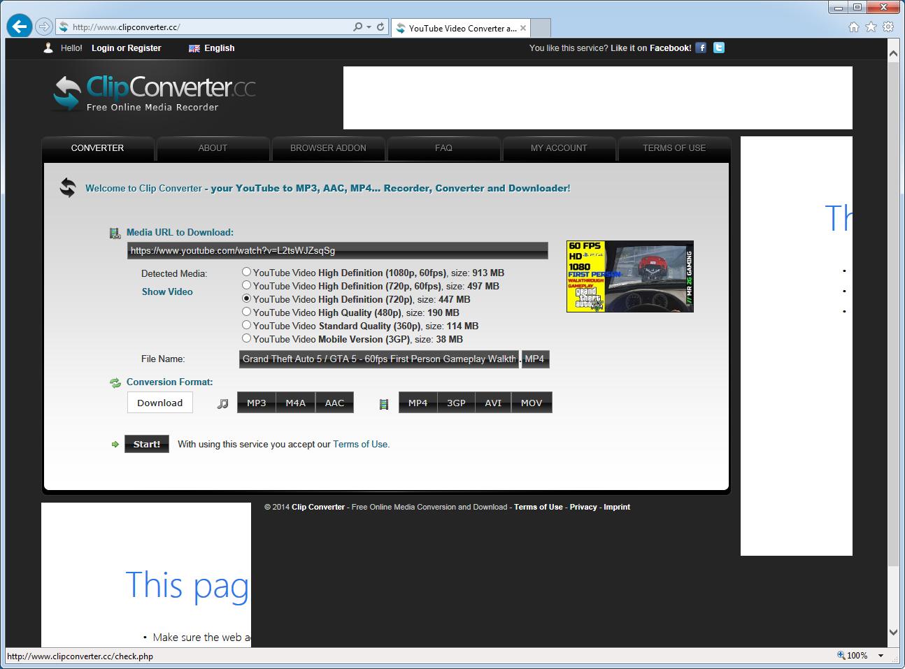

  17. Got the 1080p60 version from clipconverter.cc. As was pointed out earlier, it's really 30 fps with dups. Clipconverter.cc only shows 1080p and 720p available at 60 Hz. Which pretty much verifies what the OP claimed:
    [Attachment 28892 - Click to enlarge]
